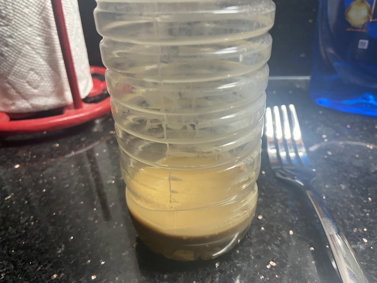

    This was after 650miles of no towing.
    I absolutely think they are worth the $200 bucks.

    That is from a GMC sierra 3500. The new gas 6.6L. It is Direct Injection so I went ahead with a PCV reroute to catch can. If the engine has direct injection I would do two things.
    1. I would use high quality oils with dispersants and detergents to help keep things clean. I settled on Amsoil
    2. I would install a catch can to remove soot and water that the engine oil can't clean
    This will help keep the re-used gases more pure for re-burning. I think the new tundra has both port and direct. So I think a catch can is work it.
