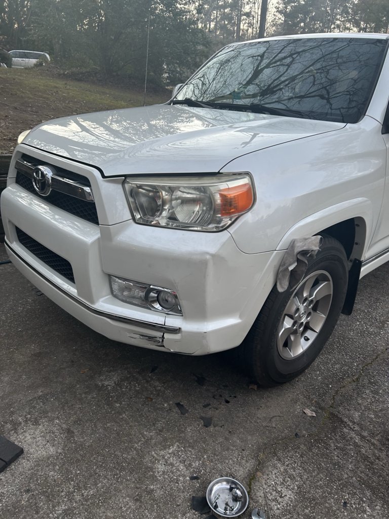

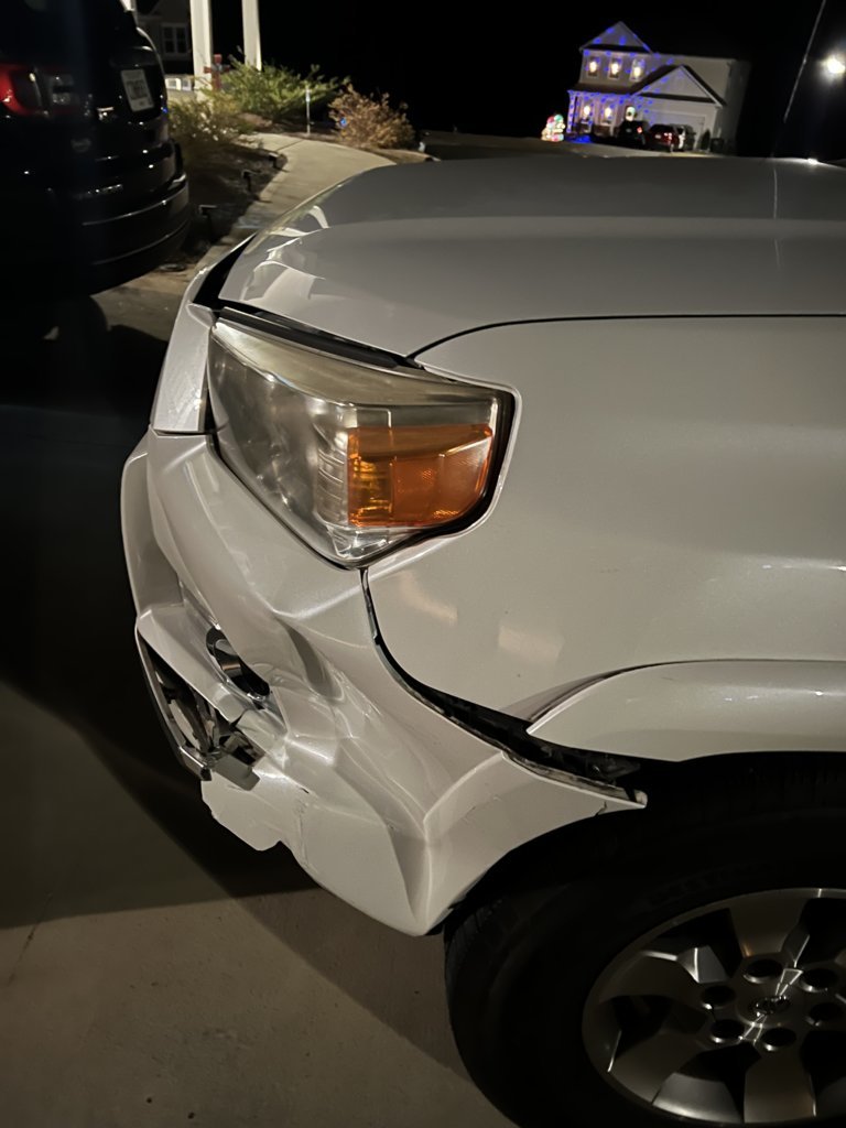

  25. Jan 7, 2025 at 3:45 PM
    #25
    Dcsk8terantz
    Dcsk8terantz [OP] New Member
    Sep 4, 2020
    #51750
    47
    Gumby McStaniel
    Atlanta, GA
    2020 4x4 SR LB
    Trans cooler Westin brush guard Bed cover Driver entry handle Full radio and speaker upgrade w/SW Seat covers
    5 hours after driving test my daughter had her first mishap. 6 hours fixing on a Saturday and thank the good Lord it was only minor damage to the car and no damage to her or the other driver. This last post aged well…
