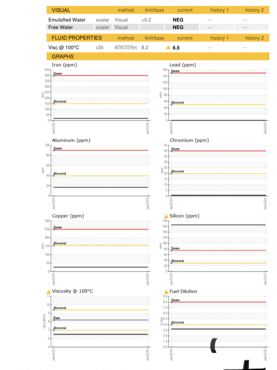

    Here are the results . Ill call them tomorrow to discuss the results.
    I just called them to discuss the report . The lab technician failed to take into account that it was a brand new vehicle with only 1000 miles .
    Silicone high level - Normal for new engine assembly due to sealants used . This should drop significantly by the 2nd and 3rd oil change.
    Fuel dilution not uncommon and typical for combustion engines
    Viscosity is slightly high for the type of oil ( max should be 7 , I am at 6.5 ).
    Thoughts and opinions welcome . I will do another check at 5000 miles .

    Very interesting results, especially all the fuel in the oil.

    What does something like this cost? Very interesting results, wonder where the fuel is coming from.

    Leaking injectors, long idle times, or rings not properly seated.
    Personally, I have always drained the oils within the first 1500 miles and it's never been a bad choice for this guy.

    Interesting results, thank you for posting ! I wouldn’t be overly concerned, possibly do another sample at 2nd or 3rd oil change. A brand new engine will typically have lubes and micro debris present. Along with fuel blow by at the rings until properly seated. After 5000 miles foreign substances should decrease substantially after proper break in. I’ll be doing my first oil change between 1000 and 2000 mi. and expect to see minor metallic particles and discoloration at first change.

    Im not concerned since its the first oil change. Contaminants from a new engine assembled could be the issue but now I have a base line to view.
    Our business is in the US but I'm based in Canada and we used a local company for $25 .

    these oil condition reports are nice, but to get to "how dirty" the oil is ISO 4406 particle counting is needed.

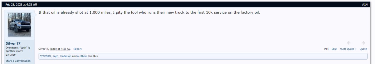

    If that oil is already shot at 1,000 miles, I pity the fool who runs their new truck to the first 10k service on the factory oil.

    Lots of cold starts vs total travel distance too

    No one has said anything of the sort. I think most people aren’t shocked that the oil on a brand new engine is going to have some break in contaminants. This just comes off as being overly sensitive to others criticisms of a truck you didn’t design or build, frankly.

    Yes oil results were a tad surprising given it was just 1,000 miles sure, but nowhere did I allude to it being a red flag in regards to whether one should purchase a 3rd gen as you seem to be suggesting. I’m sorry you have noticed my presence on this forum open for public comment, and are offended by my frequenting of some 3rd gen threads that are related to problems they may have. Those threads get hopping and keep jumping to the top of the list, so I tend to check them out. Damn me sometimes I even comment.
    Perhaps those threads are just plentiful, and I must have wrongfully thought I was allowed to engage in tundra related discussion on a tundra forum in regards to a vehicle that could be a prospective purchase. If you like I’ll just avert my eyes from the 3rd gen problem threads and purchase one in blissful ignorance in a few years.

    Update
    Note - love the truck

    I would keep it up. Early drain and fill is money well spent. Turbocharged motors require a little earlier oil changes anyway. Do mine at 5000 miles. My onboard diagnostics says I can go to 7500+ miles but never do.
