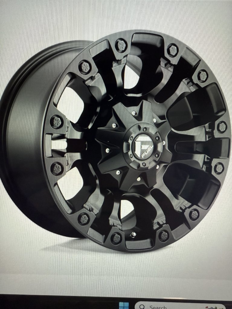

    I am looking to upgrade to the pictures below of wheels and tires.
    fuel vapor 18x9 with +20mm offset.
    wheels are stock 275/65R18, but more aggressive falken wild peaks AT4W.
    How much wheel poke would I have?
    I keep getting many different numbers from calculators online.
    Also, similar pictures or models sizing please post to help me visualize it!
    Wheels are so expensive I just wanna be sure.
    also, if anyone know, at what “Poke”, does spray become a problem for the side of truck?
    for example keep under 2 inches?
    Thanks again!

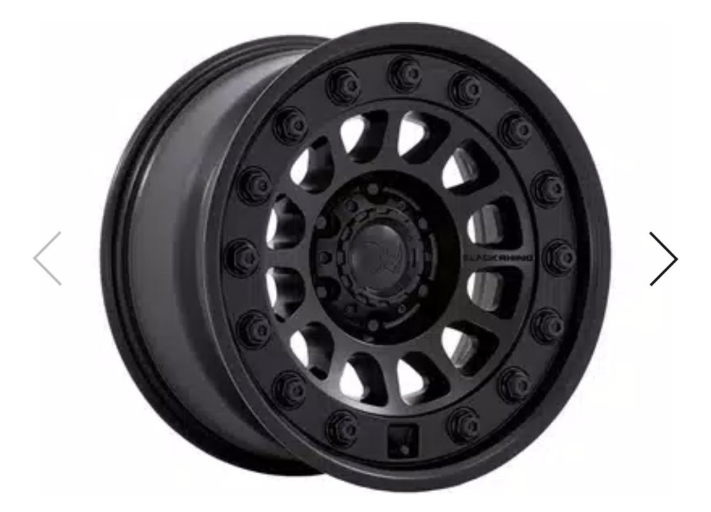

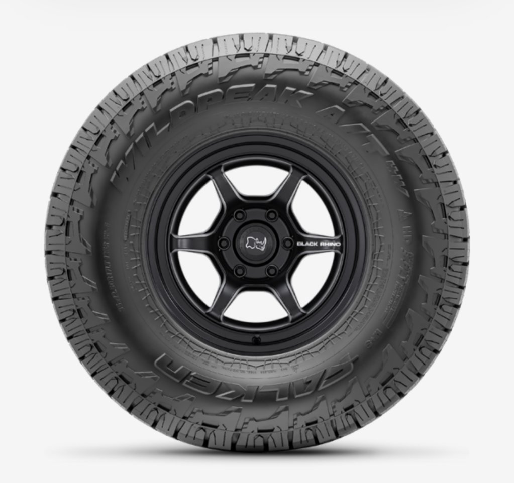

    the other option is the a black rhino wheel 18x8 with 32mm + offset,
    see other image
    Not sure if anyone thinks one brand is better than the other, black rhino vs fuel?

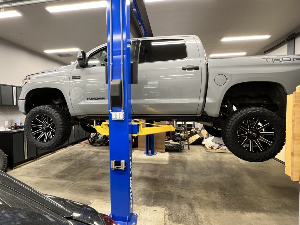

    6” lift, 35 inch tires, chrome delete, ridiculous stereo

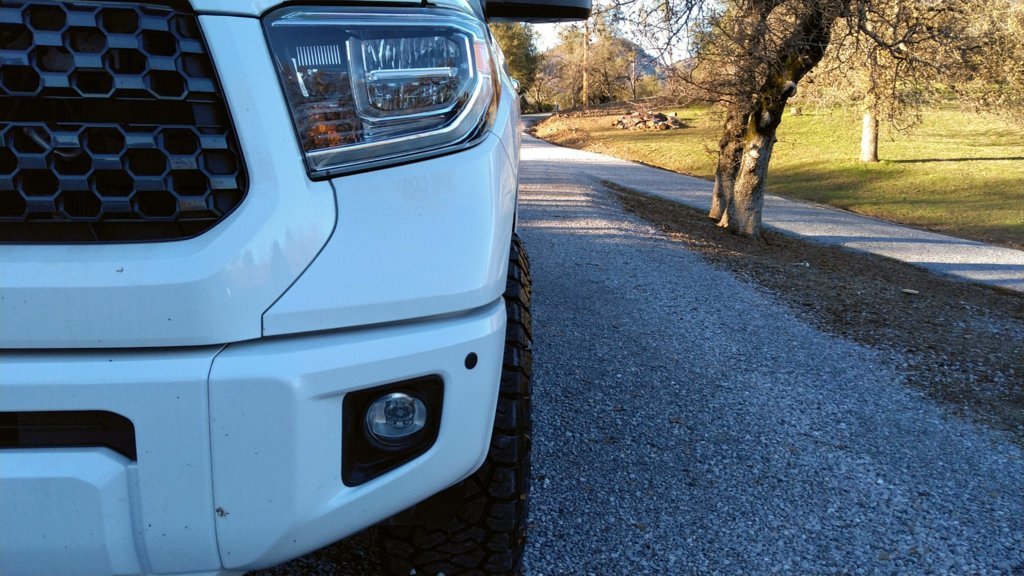

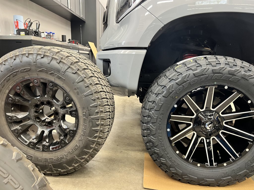

    20x9 fuel Contra. (Ironically I had Vapors and sold them.) 1mm offset. 35x12.5 Toyo open country RT. IMG_1223.jpg IMG_1227.jpg IMG_1225.jpg

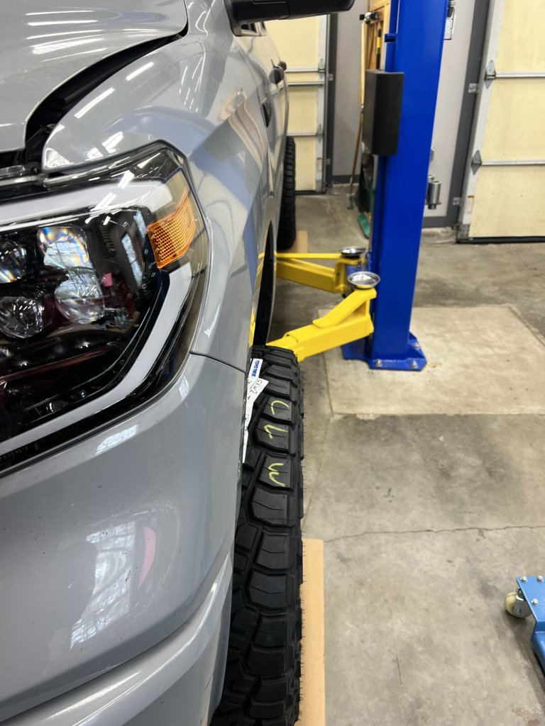

    5100s, Icon Rebounds, Maxxis Razors
    KIMG0109.jpgIcon Rebound wheels 18x9, 25mm offset with Maxxis 275x70x18

    Nice, do talk get a lot of sling on the side of truck?
    Did you sell them for more offset?

    The truck had vapors on it when I bought it. Just not my cup of tea is all. Plus, they were 18’s and I wanted 22’s……until I took a ride with them. The ride was awful. 20’s were a compromise. I still prefer the look of the 22’s though. The sling isn’t bad at all. 4” or more of poke and you have a mess.

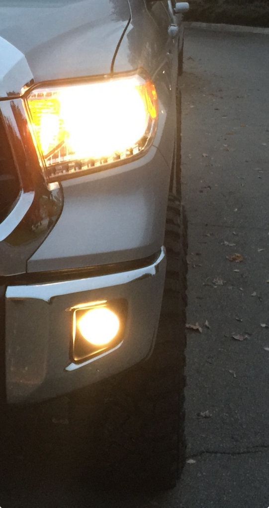

    How much did the vapors stick out for ya? Any sling?
  9. May 18, 2025 at 2:01 PM
    joonbug
    joonbug °°°°°°°°°°
    Oct 13, 2015
    #1948
    16,854
    Joon
    NorCal - Dublin
    2020 LT DC
    Moved this over from other thread.
    It’s my old truck. Was +25 on 295/70/18. Personally I think it was the perfect poke. Doesn’t look like much poke in the pictures but it was perfect in person. Just enough to look aggressive without looking out of place. My current truck pokes out much more and I have a permanent rooster tail on the side of my truck. Unless you’re going for “that look”, I’d suggest staying at 1.25-1.5”.

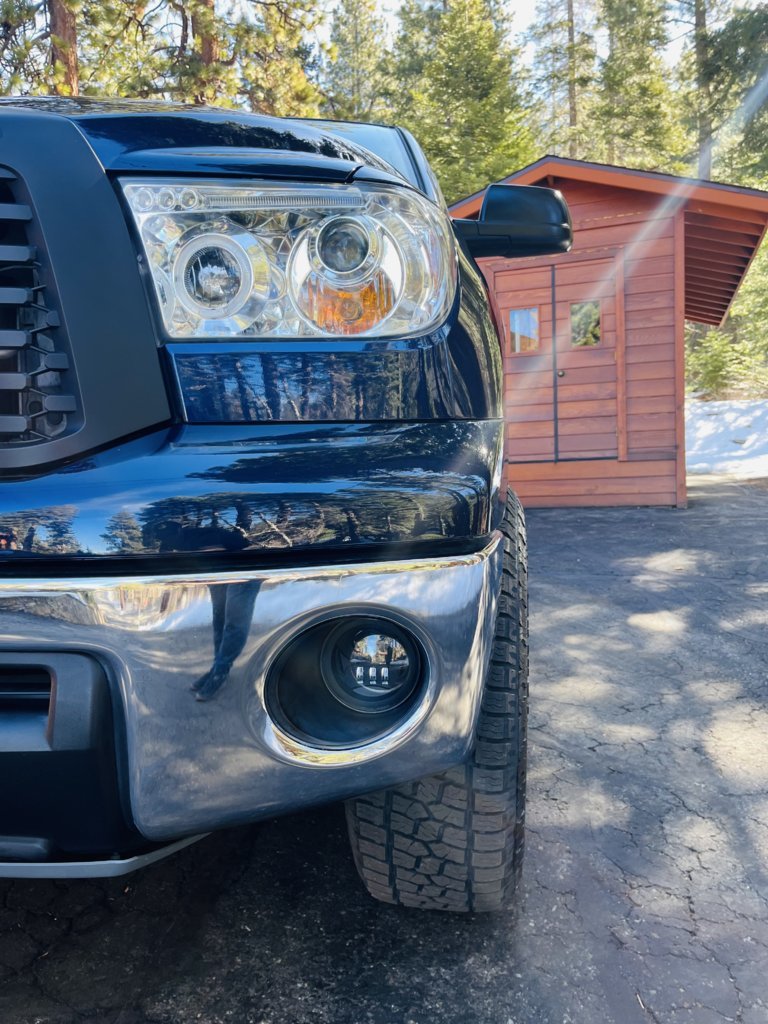

    2010 Tundra 4x4
    17x8.5 +06mm 285/70/17

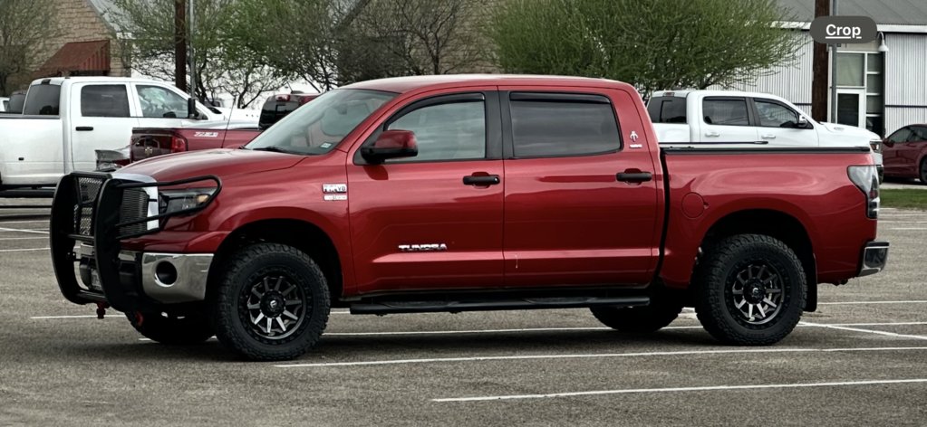

    2011 Toyota Tundra SR5 Texas Edition (Crewmax) 4x4

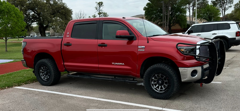

    12x9 20" Fuel Covert +20mm offset
    Kenda Klevers 33x12.5x20
    Tundrav82019[OP] likes this.

    So you get a lot of sling on that tire?
