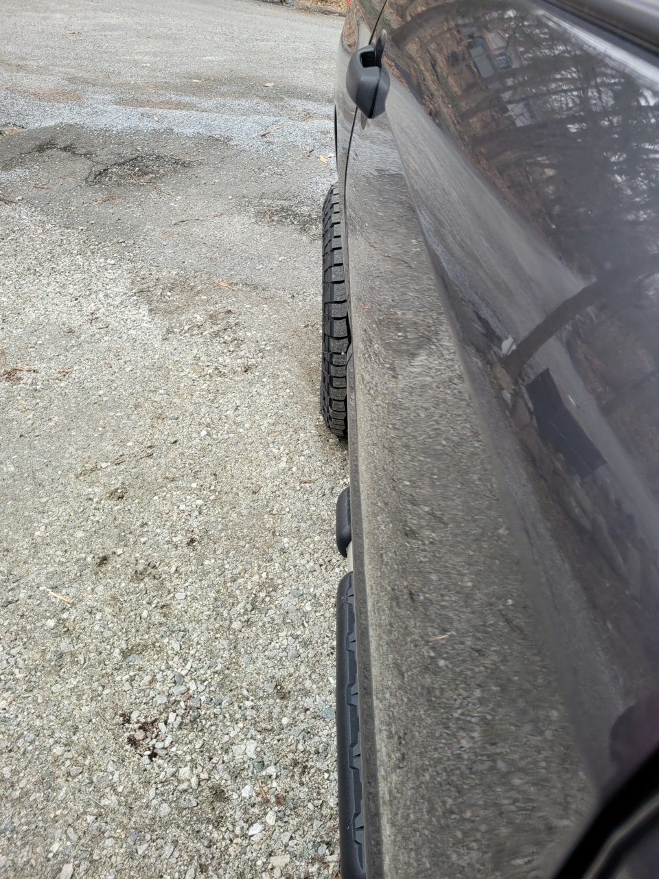

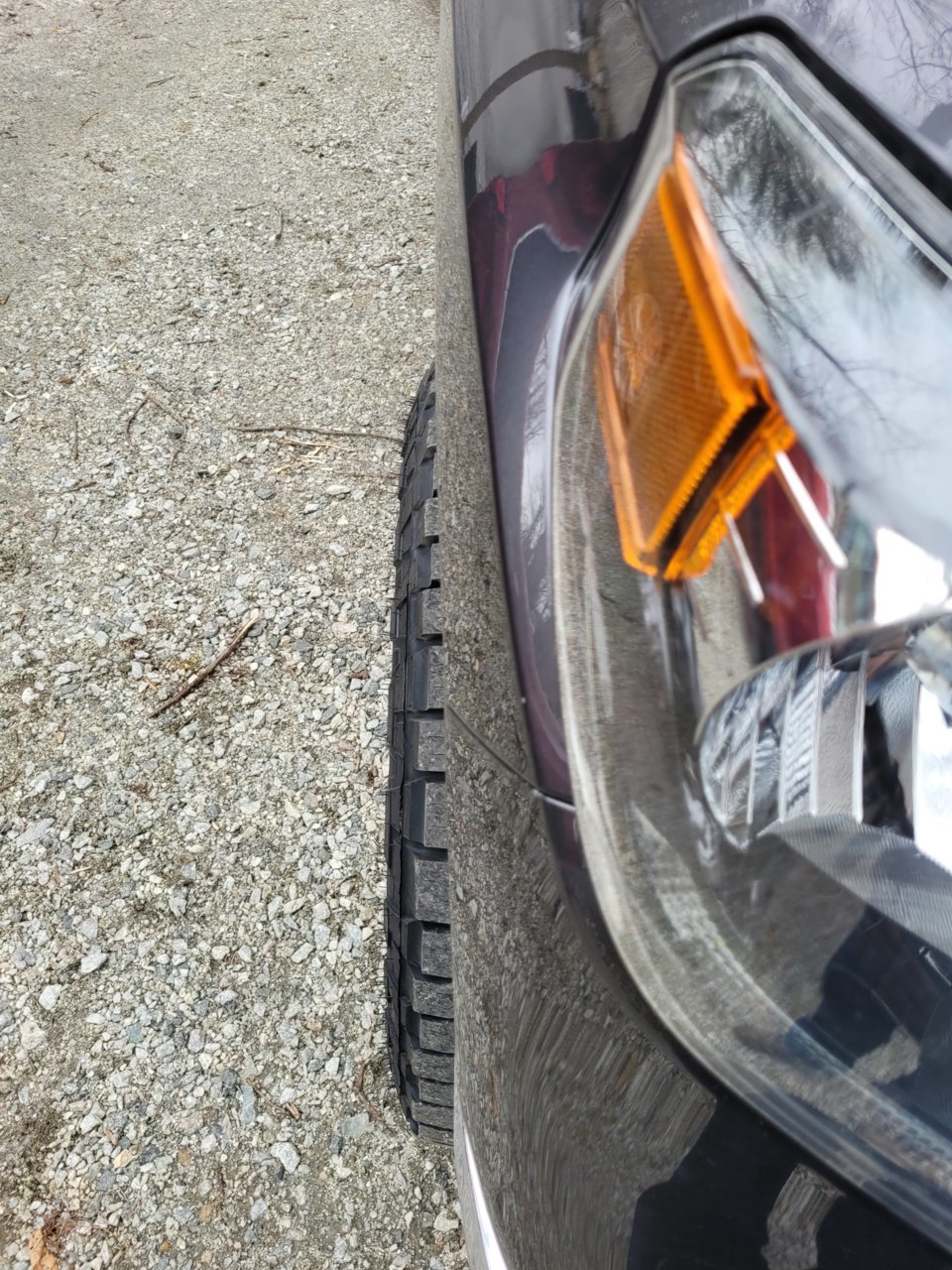

    SCS wheels, Cooper tires 275/70R18. +25.offset.
    Very minimal poke, no rocks kicked up the side of my truck, no need for flares. Keep in mind, Offset is the first thing that determines poke, but tire width also plays a major role, and every tread/manufacturer varies.
