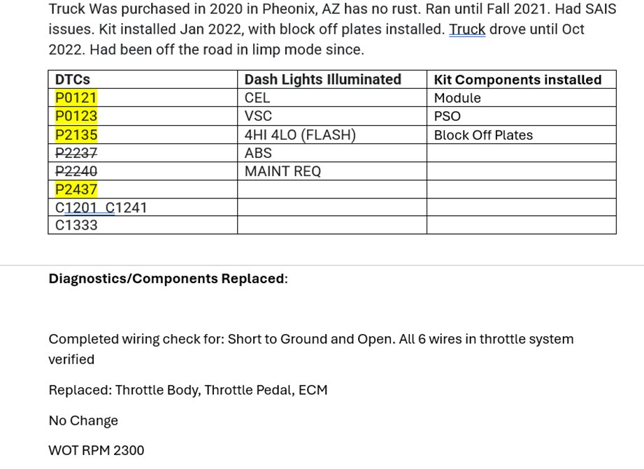

    In need of help.
    2011 RCLB 5.7 in limp mode. Will start. Indicates following codes:
    I am stumped. Kit discussed is a Hewitt SAIS bypass kit. Would appreciate all ideas and thoughts. Thanks!
