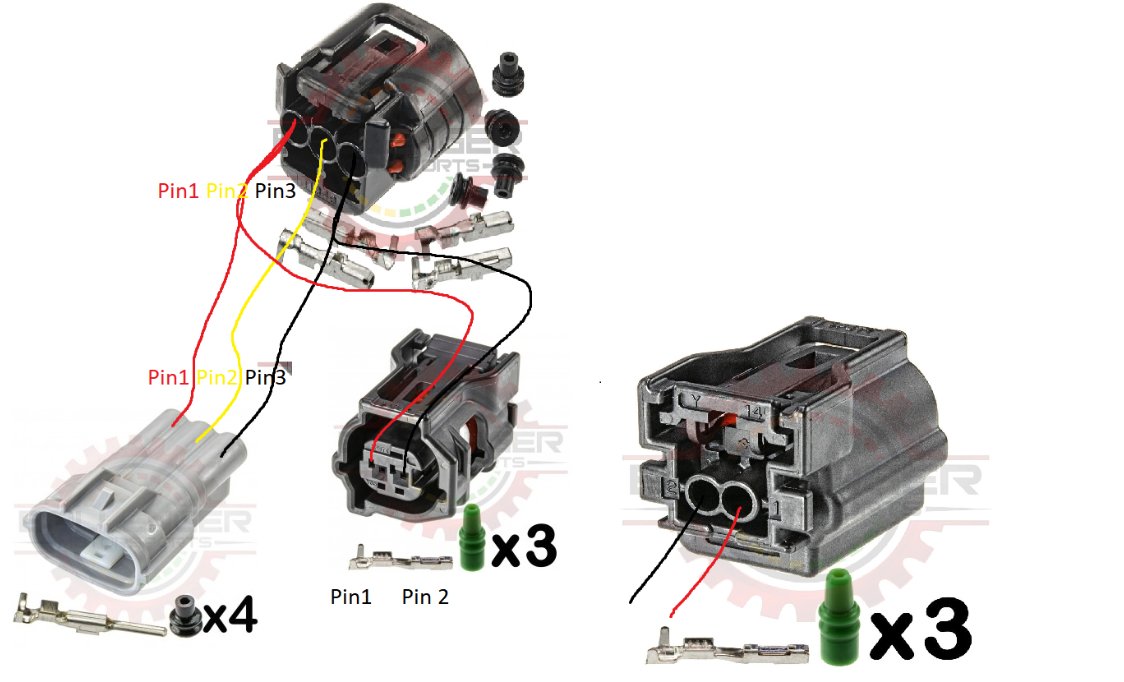

    I bought a harness from bmotorsports.com. Im going to tap the active shutter since it's power, ground and signal. The total was $51.66, but I figured that was better than having to splice something and deal with it later down the road.
    EDIT: I gave bad info and it seems this does not actually work :|
    Edit again. The picture has the black/red going to the wrong pins. I repinned it and it lights up now. Bad news is it's always on.

  7. Jan 25, 2024 at 9:11 AM

    What plug are you referring to?

  9. Jan 25, 2024 at 9:13 AM

    Is this plug that'll plug it right into the factory wiring harness?

    How would this work? What would be the connection points? the OEM marker lights would connect to the shutter plug?

    Assuming you have the active grill shutter (Not sure if they all do), you would simply unplug the connector for it, and plug this in to have a lead off the power ground into an oe plug. Then connect the OEM TRD lights to it since it's just a break out to harness power. So we're just tapping power and the Active grill shutter would still get plugged back in and work.
    Any time the truck is on, these will turn on.

    Ok, I guess what I'm trying to figure out is what the plug you're referring to is for.
