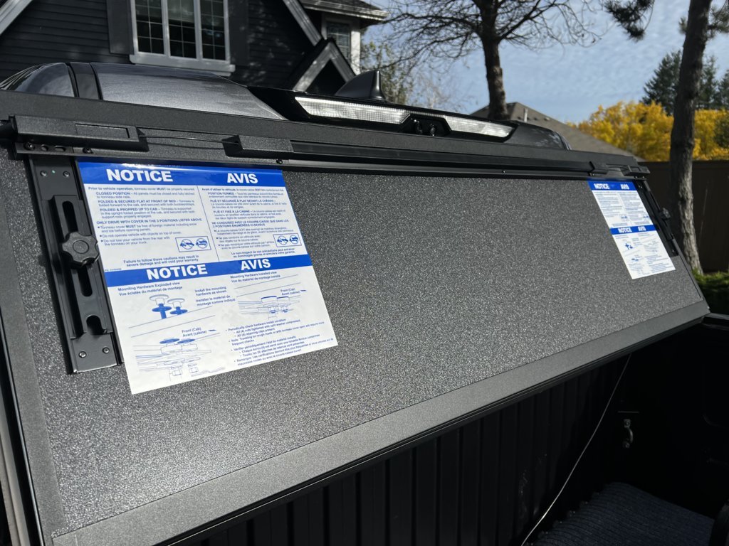

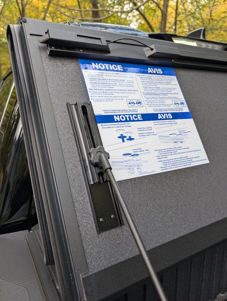

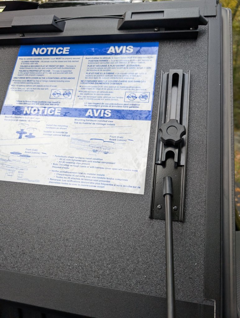

    The mounts for the support rod on the driver's side seems to be mounted too low. The right side is perfect, it allows for the support rod to sit nicely when fully folded. On the driver's side, the mount is a couple of inches lower, so the rod can't get in there, even with the slider all the way up. Curious if I'm being an idiot, if this is a known issue with the tonneau, or if this is unique to me. In the photos shown, the close ups of each side are with the mounts at maximum height.
    This isn't the first tonneau I've owned, and it is the OEM Toyota tonneau that was on the vehicle when I bought it. Curious for any thoughts, and I'll certainly follow up after showing the dealer in a couple weeks.

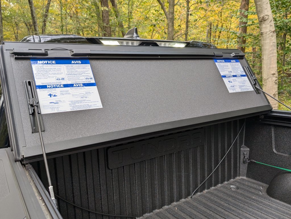

    In the meantime, I managed to remove the sliding bracket on the mount by taking the tightening screw out, lowered the prop fully, and was about to mount the sliding bracket directly on top of it. It is a super tight fit and definitely not what is intended. Here is a photo before I undid it.

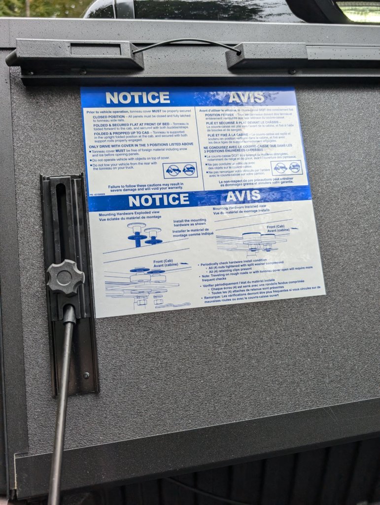

    Okay…so mine are in a completely different position. I’m guessing that bracket is installed by the dealer, as part of the overall installation, and it’s up to their own judgment where they should be placed.

    Wow, yup, that's what I suspected. I'm not sure those brackets can be relocated, both because of the holes it would leave behind, but also because the fasteners look like small rivets.
    Thanks for taking this photo, much appreciated.

    Wonder if you can adjust where the rods are mounted. I haven't looked very close at that part. But since my brackets are mounted so much higher, my rods must be closer.
