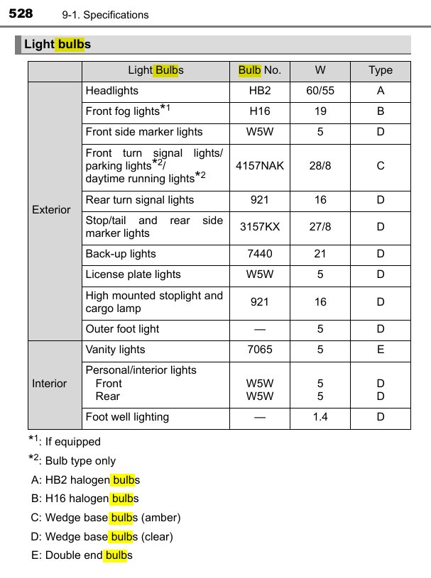

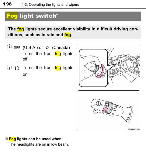

    Hey I recently picked up a 2017 Tundra limited. Im assuming the fog lights are burned out (unless there’s a secret switch I’m missing) because they wont automatically come on with the headlights.
    I’m struggling with visibility at night when taking turns. Do the OEM bulbs do a good enough job or should I upgrade to something else?

    Have you checked your stalk for the fog light position on the steering column? Can you see the actual OEM fog lights?

    The fog lights don't automatically come on with the stock set up. Check your user manual for how to turn them on and confirm if they are burned out before you mess with replacing.

    Welcome to the forum.
    You can find your manual here.
    You don't need to make an account.
    Toyota Manuals and Warranties | Toyota Owners

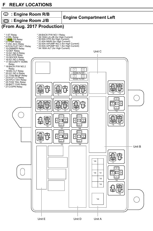

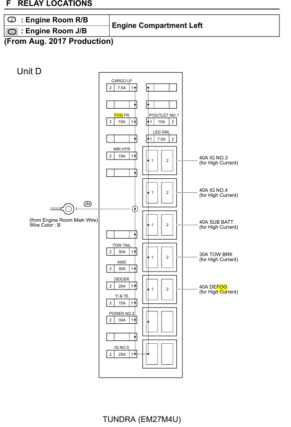

    Fog light fuse is under the hood.
