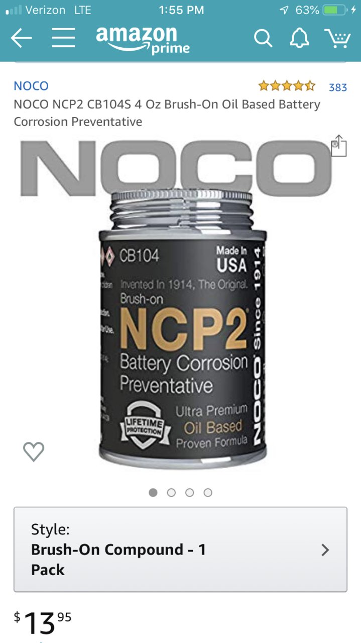

    No. They all will corrode over time. The best thing to do is use this stuff sparingly after cleaning the terminals.

    I have used the Castle brand. I am hearing that the metal terminals will corrode a lot faster than lead. I have learned that once a terminal corrodes heavily, replace it because you will never eliminate all of it. I cleaned it and replaced the battery last weekend. Within 5 days it was corroded enough that the truck wouldn't start. I put a new terminal on it from Autozone and no corrosion as of yet.
