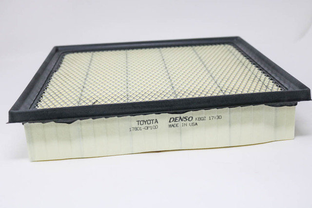

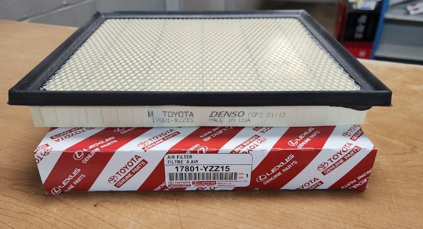

    Anytime you receive a part that has YZZ in the P/N you are getting Toyota's economy line. With some parts it is the only option as with the oil filter right now. But for air filters you can still get the original and should request it as it is much larger. Brake pads are also a part where you never want the YZZ P/N and if they hand it to you walk out the door if that is all they offer.f6f7056956308009aea406167f64bb27.jpg s-l1600.jpg

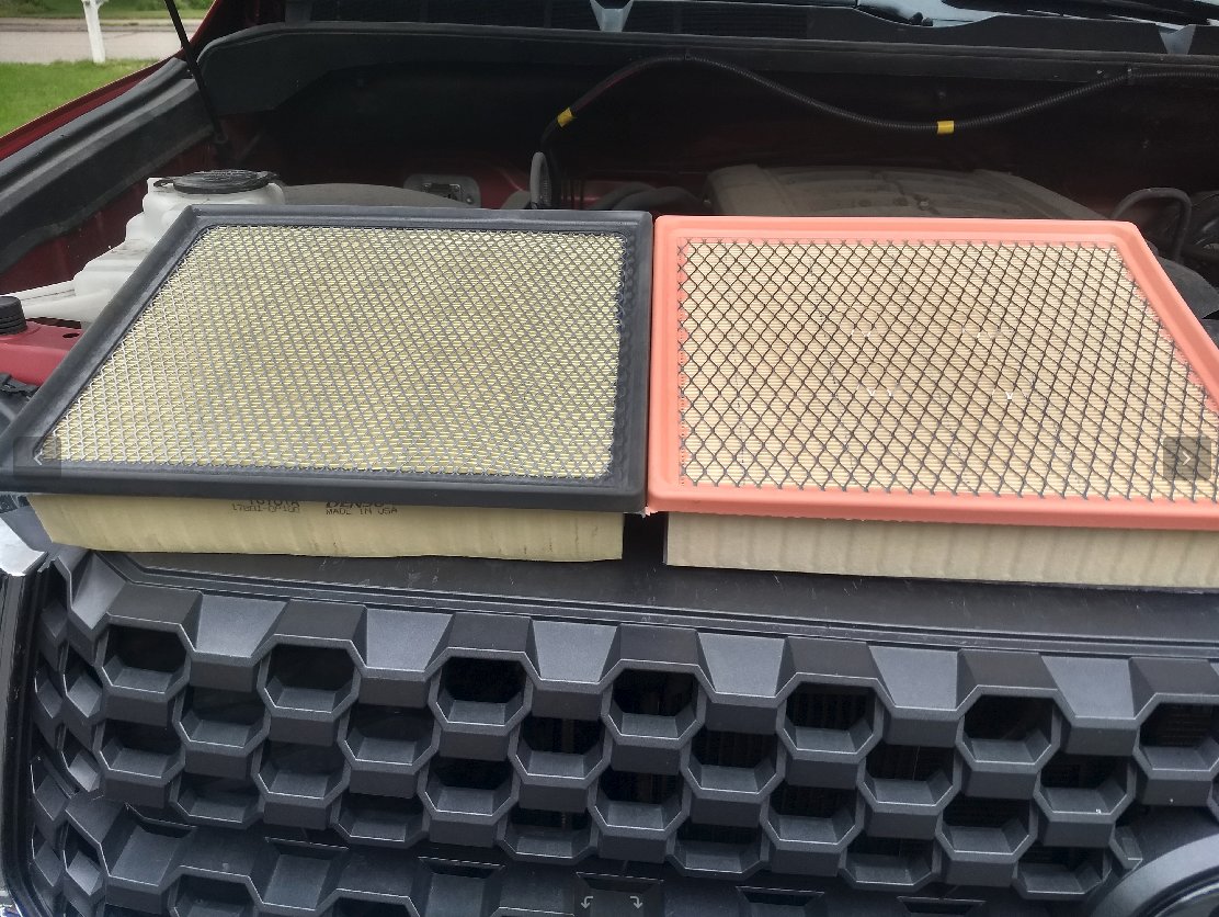

    Factory-equipped air filter in my 2019 SR5 TRD Offroad had a prefilter glued to it. The rubber seal was orange, not black, like OP100 has. I wish I took a picture of its part number, but I did not. Anyone knows the number?
