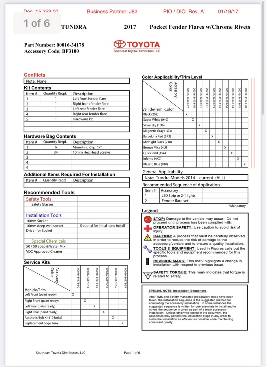

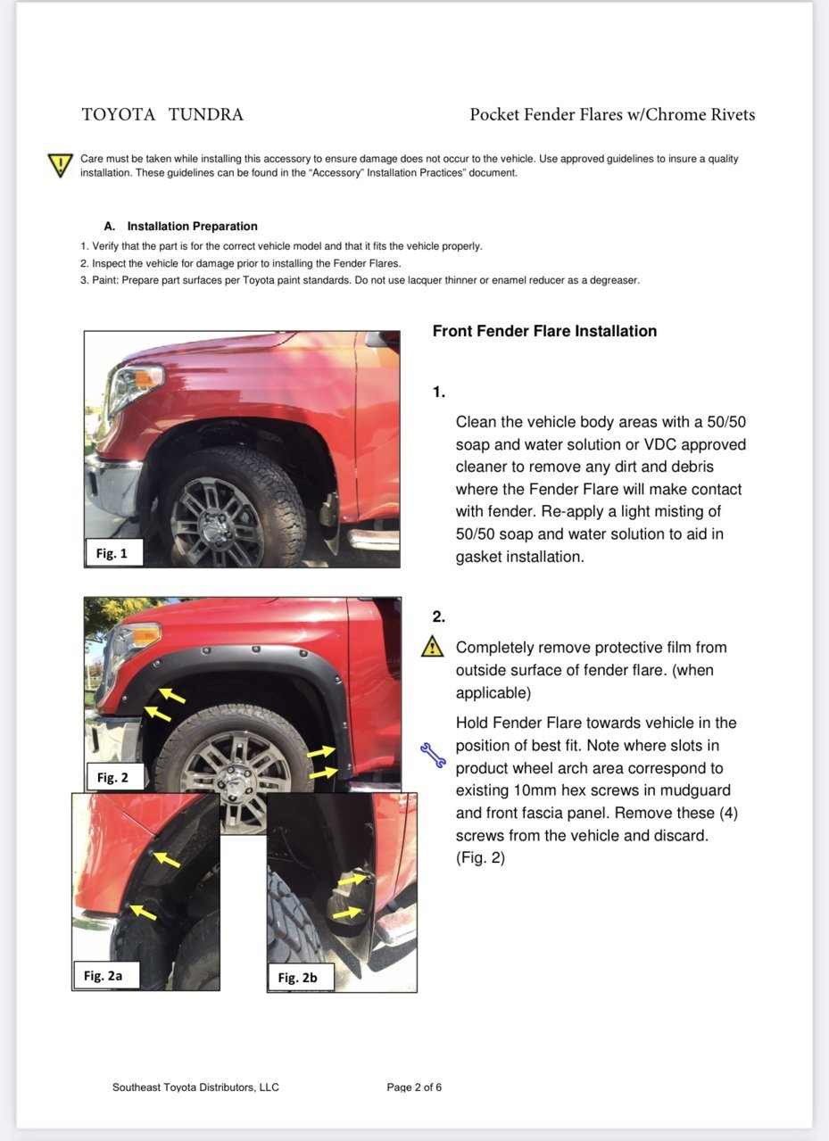

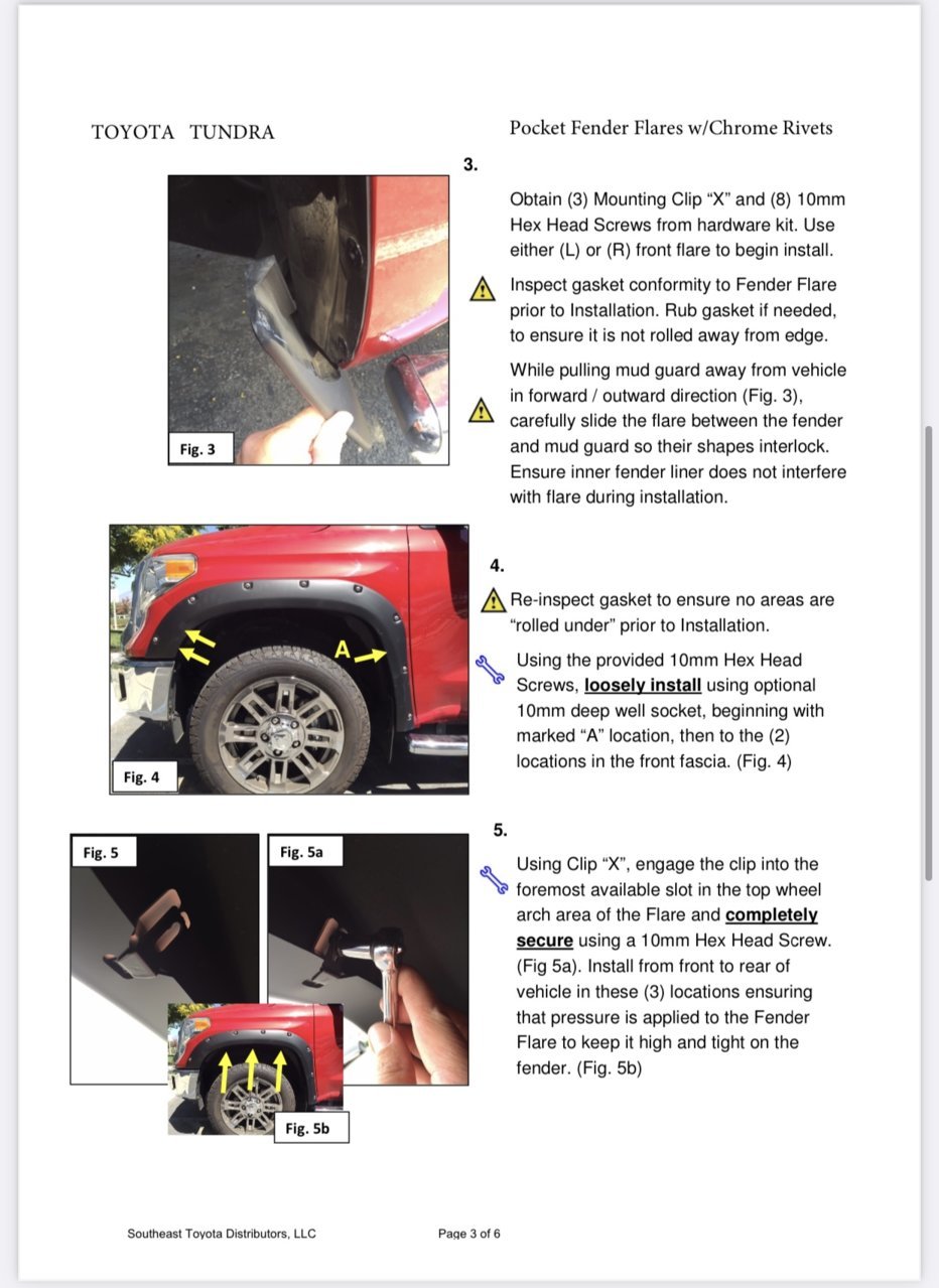

    I know that the topic of flares is a bit over kill but I have yet to come across one that says you can retain your mud flaps with Toyota pocket style flares.
    I recently bought a set from my dealership and have watched a bunch of YouTube installs. I notice on the bushwacker, there is a bracket that is provided that’s installed in the upper center wheel well.
    On the OE one I bought, they did not have this so I googled instructions.
    Any of you have this installed with the mud flaps?
