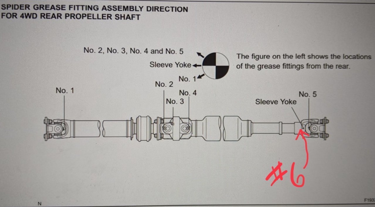

    Wait, did I read correctly above: It happens while idling stationary and while driving?
  15. Sep 28, 2023 at 5:15 PM
    Mr.bee
    Mr.bee King Turdra
    Jun 4, 2022
    #79178
    6,424
    SATX
    '02 AC TRD
    When he said idleing i think he meant coasting.
    Galladanb[OP] and KNABORES like this.
  16. Sep 28, 2023 at 5:28 PM
    shifty`
    shifty` Animals and insects don't do drugs
    Jun 20, 2020
    #48239
    28,780
    ATL
    '06 AC Limited V8/4WD
    If it's vibration while in motion, one big determining factor can be whether the vibration starts/stops in one of the following conditions:
    • Starts during acceleration
    • Starts/stops when you let off the pedal (i.e. begin coasting)
    • Starts/stops in specific speed ranges
    • There are a couple other cases I'm not thinking of because brainfog
    Based on the confusing explanation above, what I'm interpreting from OP's symptoms is we've got a bad u-joint afoot. OP can grab on either side of each u-joint while under the truck and attempt to grab the driveshaft on either side of the u-joint and push each hand in opposite directions to check for play in the joint (some play is normal at carrier bearing, so don't overreact if found)
    Galladanb[OP] likes this.
  17. Sep 28, 2023 at 5:35 PM
    EmergencyMaximum
    EmergencyMaximum New Member
    May 28, 2022
    #78904
    1,487
    Interesting illustration. Thank you! I'll want to check mine next time she's up!
    Mr.bee[QUOTED] likes this.
