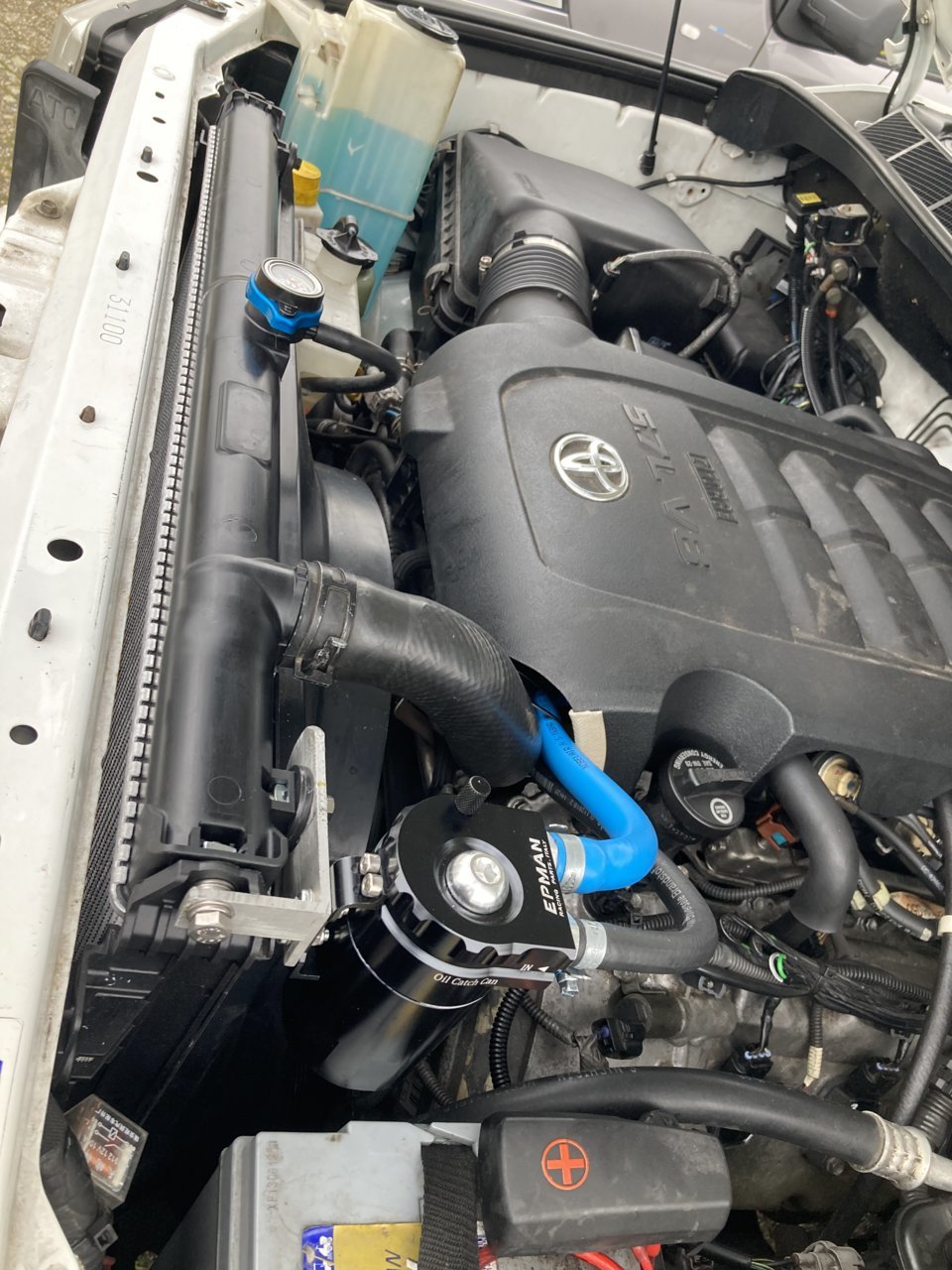

    ADD a oil catch can to your PCV valve, I did and it’s catching a lot of milky coffee oily stuff in there you don’t want in your inlet !
