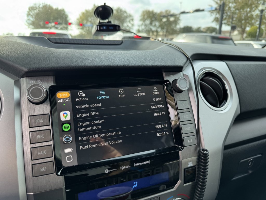

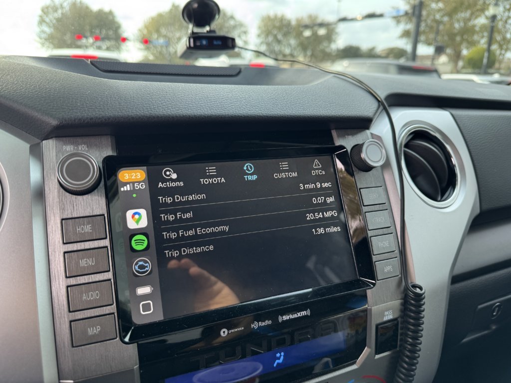

    Do these numbers look right? Temps for engine oil, coolant and transmission? First time I read these temperatures and data in CarPlay. Pretty cool app and setup honestly. I purchased the custom Toyota PID package which got hundreds of pids available.

    Those are normal transmission temps for a truck with no cooler. With a cooler it will be more around 180-190. Guessing there's some reason you're using OBD fusion over the OBDlink app. The OBDlink MX+ comes free with all those PIDs in the app. Also there is no engine oil temp sensor, it just estimates it and it basically will follow suit with what ever your ATF pan temp is so no real use to look at the engine oil temp.

    Those is the same temps my truck ran on my recent road trip. 195-201 ECT and 205-212 trans temp

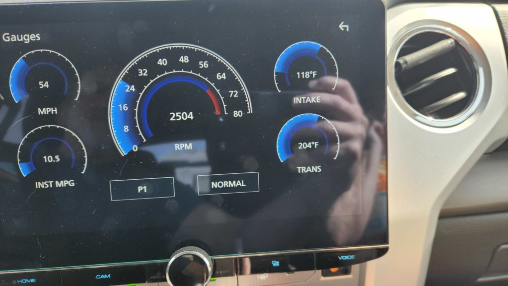

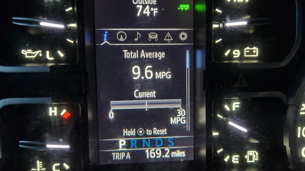

    I'm on a camping trip now, first time towing since installing the Kenwood and Maestro, giving me the ability to monitor trans temps.
    S4 @ about 62-ish MPH, towing from San Diego to just this side of Yuma.
    On the flats she settled in at 210°-212°, and climbing the grade out of town up to just over 4,000' the highest I saw was like 228° and temps immediately started dropping once we plateaued.
    169 miles, with a 9.6 MPG average with a 5,500 lb. parachute.behind me.
    All in all, not bad.

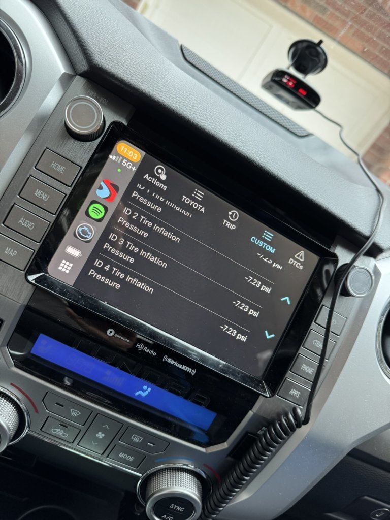

    It doesn't show the pressure in PSI :( See image.

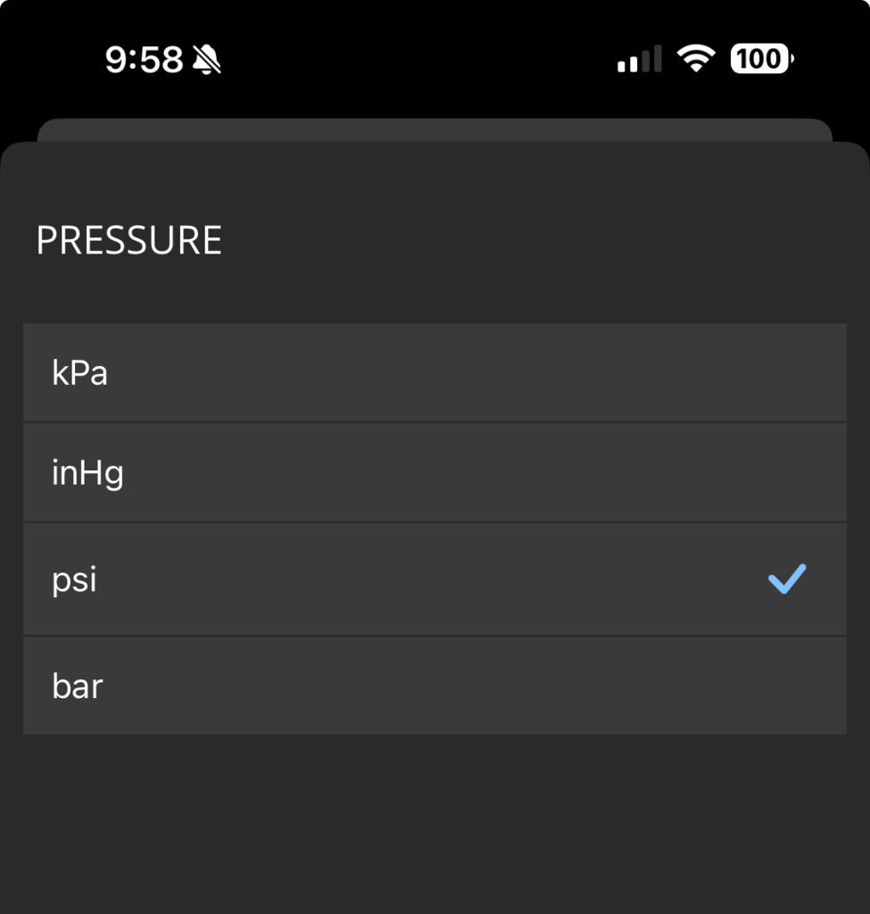

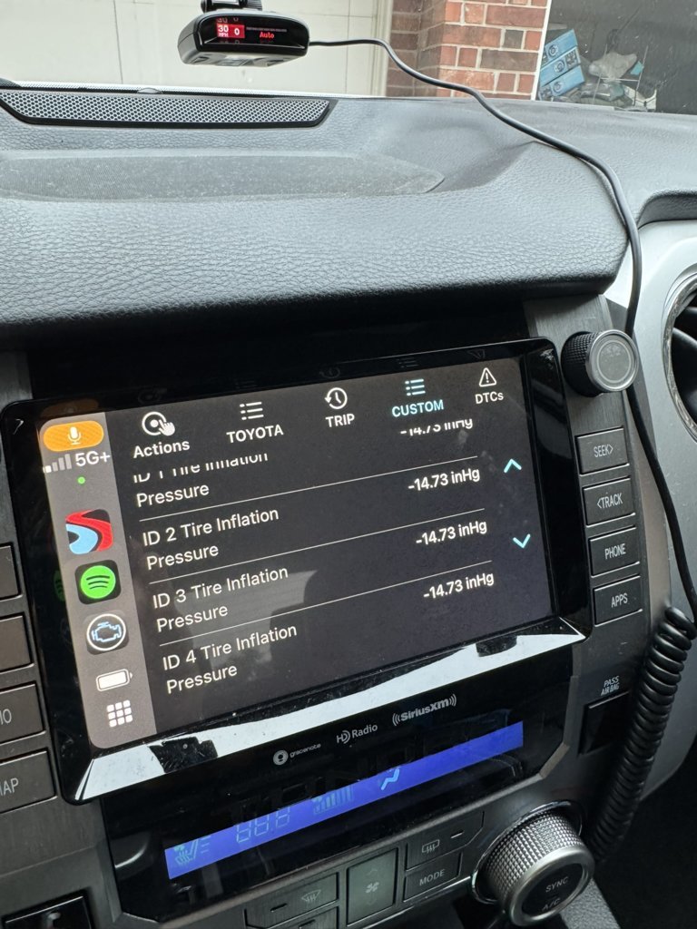

    I'll bet if you play around in the app there's a setting to change the unit of measure from bars (or whatever the hell that is) to psi.

    You Sir are a very smart man. I am going to give you the Turkey award :)

    I’m curious if that results in a more reasonable number. Aside from the fact that the number shown originally is negative (help, my tires are imploding! :(), 14.73 mmHg is only a bit over 7 PSI…

    You Sir suck because you're correct. No Turkey award for you :)
    But yes, it looks like my truck is on Mars now

    Is kind of silly not to get the right PSI readings since the data is there. I will ask the app support "whatsup"

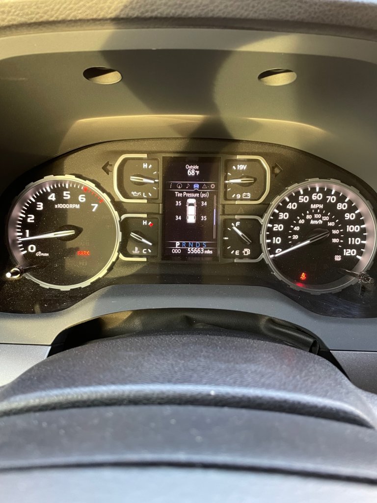

    Doesn't your instrument cluster have individual tire pressures?

    How do you get to that screen on the instrument cluster? I had it at one time, but have lost it to MPG now.

    You just arrow over using the steering wheel control button. Once to the car icon you may have to arrow down.

    OK, got it! Thanks guys! I guess you are never too old to learn new tricks on these Tundras!
