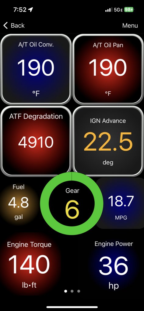

    that’s what I used. Worked great. Gives pan and torque converter temps

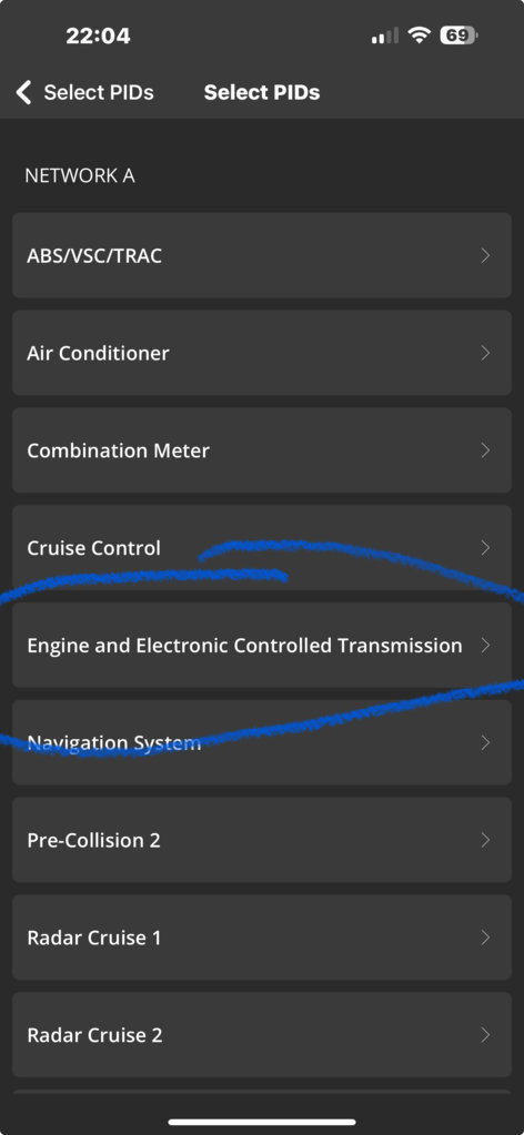

    Also, I believe you have to connect to Network A (the one that has the engine amd transmission diagnostics) to see it. If I remember correctly...

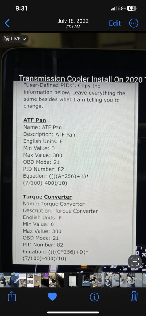

    Trans temps need to be done in manual PIDs.

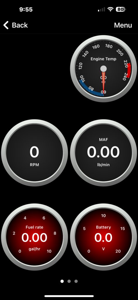

    this is what mine looks like

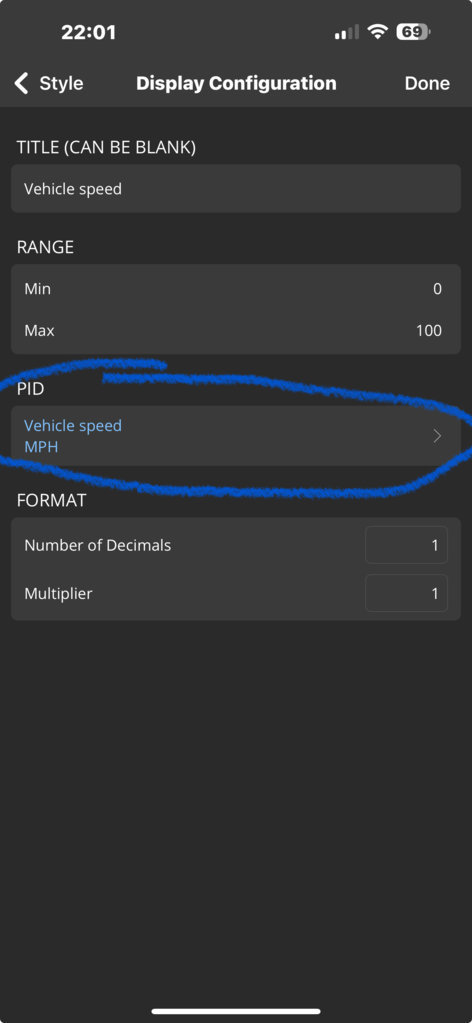

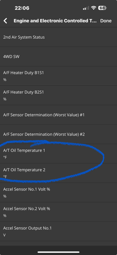

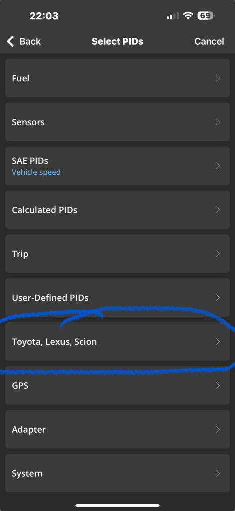

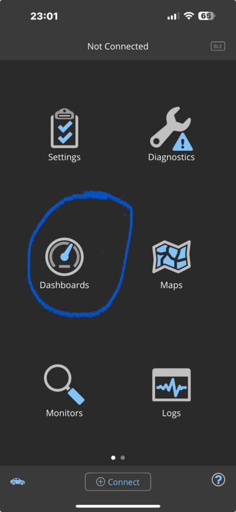

    1. Select Dashboards
    2. Select Menu
    3. Select Add Display
    4. Add display.
    5. Select gauge. Hit next.
    6. Pick gauge color.
    (Pics start from here)
    7.Press where it says PID.
    8. Hit where it says Toyota, Lexus, Scion.
    9.Hit where it says Engine and electronic controlled transmission.
    10. Hit the A/T oil Temperature 1.
    11. Then repeat to do all again for the A/T Temp 2.

    I believe AT Temp 1 is pan temp. And AT Temp 2 is torque converter.
