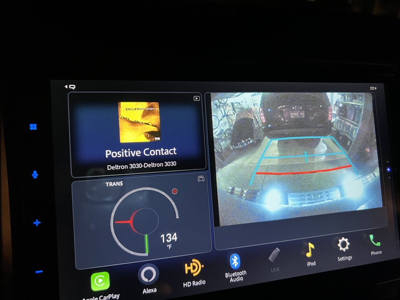

    Pay for the extra PID. Also, consider upgrading your head unit. I went with pioneer and have set up a custom dashboard with trailer view and trans temp:
