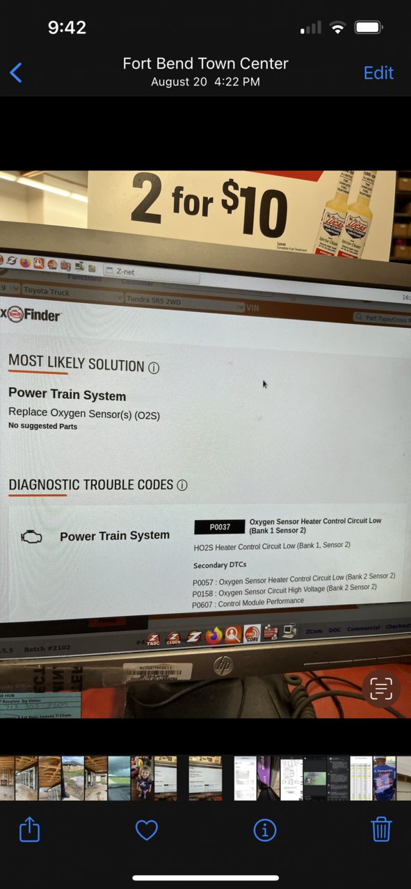

    My check engine light came on and I took my truck in to find out why. Turns out someone attempted to steal my Catalytic Converter and cut my O2 sensors. Fortunately that’s as far as they got. I have no idea what I need to buy in order to replace them myself. Can anyone help me? There is one in front of the cat and 1 after. The dealership wants over $800 for parts and labor.
