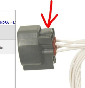

    Do you lift the connector release tab or press it in?
    Any ideas on a connector disconnect technique without breaking the whole thing?
    Any photos available that shows the disconnect detail?

    Press down on the red arrow to release the connector. Push the connectors together as you are pressing down on the red arrow then pull to release.
