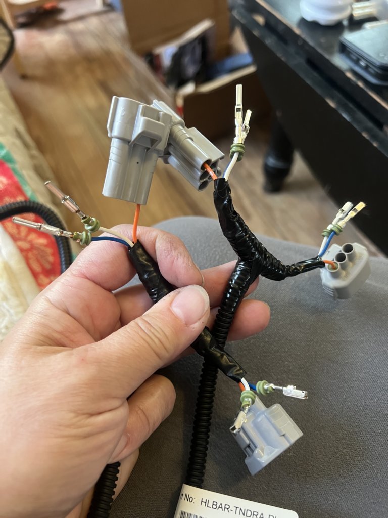

    Ok howdy and all that jazz. I’m a little late to the party on this light bar stuff so.. I’ll include a pic of what I have. The patch harness that jumpers your headlights/turn sign to the light bar harness was fully pinned. It’s a 3 pin connector and I don’t have the information for the white, blue wires. The orange is already pinned. My instructions say I’m supposed to have an additional leaflet with those instructions but I didn’t get it with my stuff. Headlight Revolution is out for Labor Day weekend. Ugh.. I’m about to just jumper it myself until I get the right combo then pin it that way. Thanks in advance!IMG_3116.jpg

    Yup looked through all the posts on this page, read and reread all the information in the instruction book. NO ONE seems to have any answers. HR only says refer to instructions but instructions say I should have additional leaflet with wiring instructions for the patch harness. Orange wire is already pinned in position 3. All photos show blue in position 1, white in position 2 but nothing says exactly how it goes. White wire is essentially a jumper from one connector to the other. Blue wires are spliced in purple wires at the other end.
