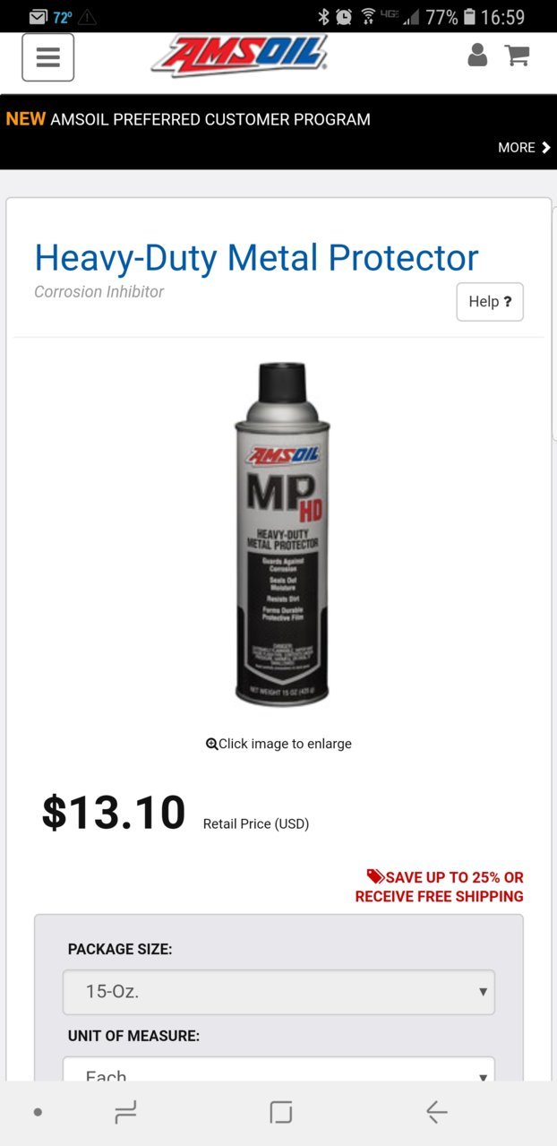

  10. Jun 10, 2022 at 8:47 PM
    29,659
    TILLY likes this.
