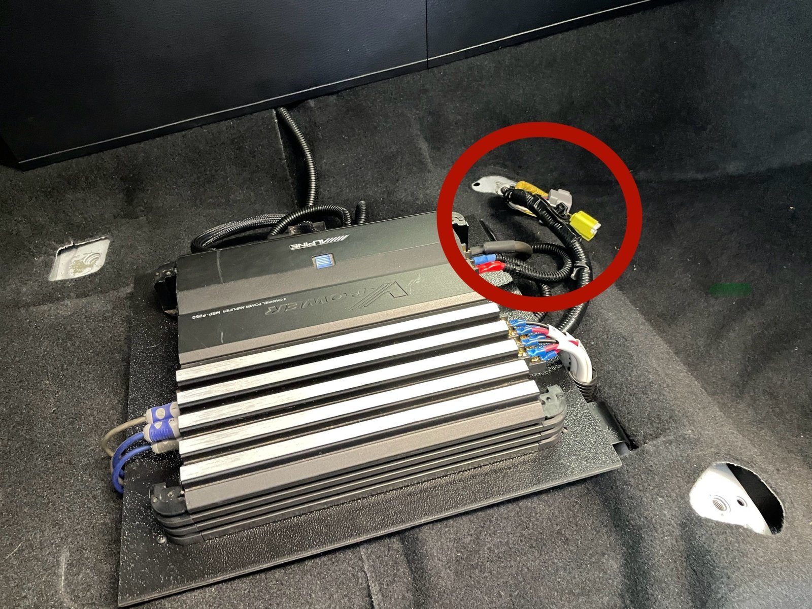

    I already ran new speaker wire and spliced it into the Kenwood wiring harness so the bypass isn't an option at this point
    . Just want to make sure the amp doesn't control anything else before I just leave it out....
    Finally got the beast back together, without the non-jbl amp installed. Sounds great, but the passenger airbag is not active and the seat belt light is flashing (but no dinging). I have to head out of town for a few days, but when I get back, I'll hook the old amp back up and see if that resolves the issue. Meanwhile, I'll keep checking in on the thread to see if anyone has any other ideas.

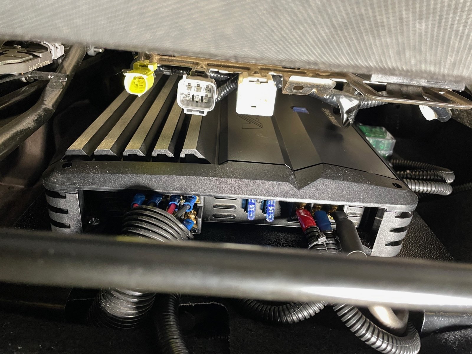

    I would imagine you already checked this.. make sure the harness under the passenger seat is completely fastened.
    1lowlife likes this.

    ^ I'd think this is the issue as well.
    Those airbag connectors can be a little tricky to secure..
