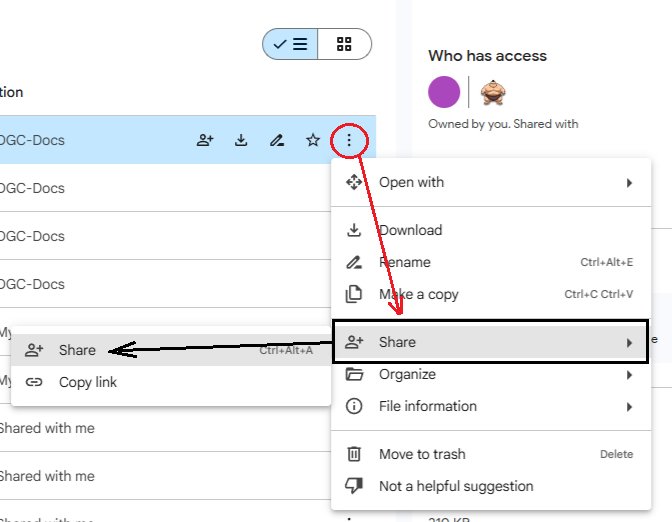

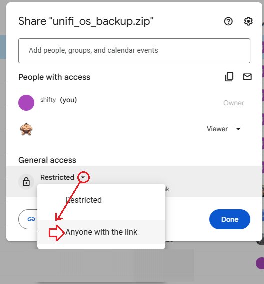

    The reason your Google Drive links won't work is because you need to find the video @ https://drive.google.com and click the triple-dot to the right of it, then choose SHARE, and click SHARE again (do this for each file). Once inside the SHARE area, you need to choose "ANYONE WITH THE LINK", then click DONE. At that point we'll be able to see it.
    Here's two pics to demonstrate that:
