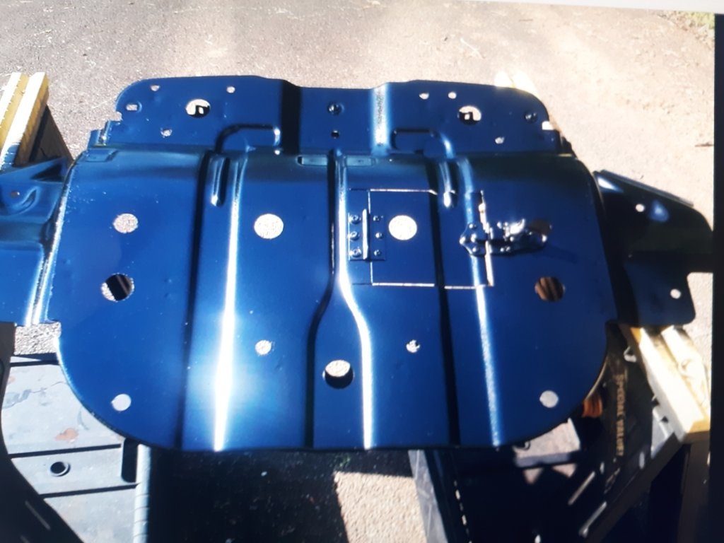

    First time I removed my Skid Plate on my 2010 was the last time.Resized_20230225_061241.jpg I cut a lockable door into it with room for filter access, then painted it up.

    Problem on 3rd gens is you need two access ports, one for the drain plug and one for the filter and they are not near each other. And a port for the filter might still leave you with an awkward and difficult access. The TRD skid actually comes off pretty easily with my cordless 3/8" ratchet. But it's pretty heavy.

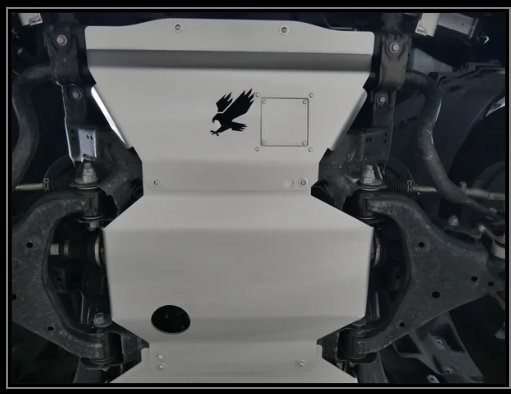

    I know you can access the oil filter through the door, you can also reach it from the side if you need to get a wrench in there.
    I think you can also get to it from the top of the engine bay incase you need to get a lot of leverage on the wrench after someone puts it on way to tight. I know for a face the F-150's you can do this but I am not 100% sure on the Tundra as it has been awhile since I looked at it.

    Yeah, from the photo on your web site I know you can "see" the filter. But whether you can do anything with it is another question. I'd have to see this setup in person... or maybe see a video of how to work the filter through that opening... before I'd consider swapping my TRD skid for one of these.

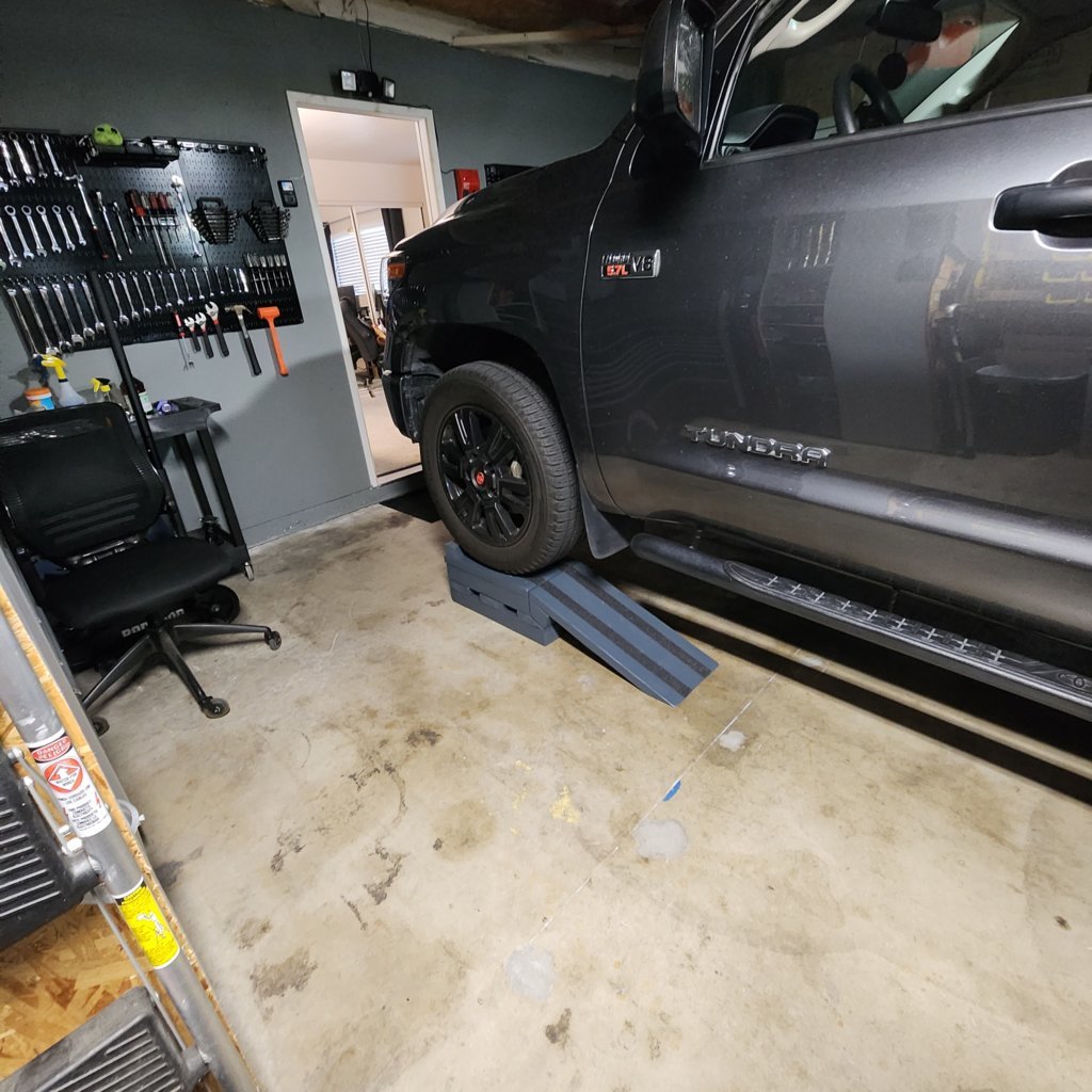

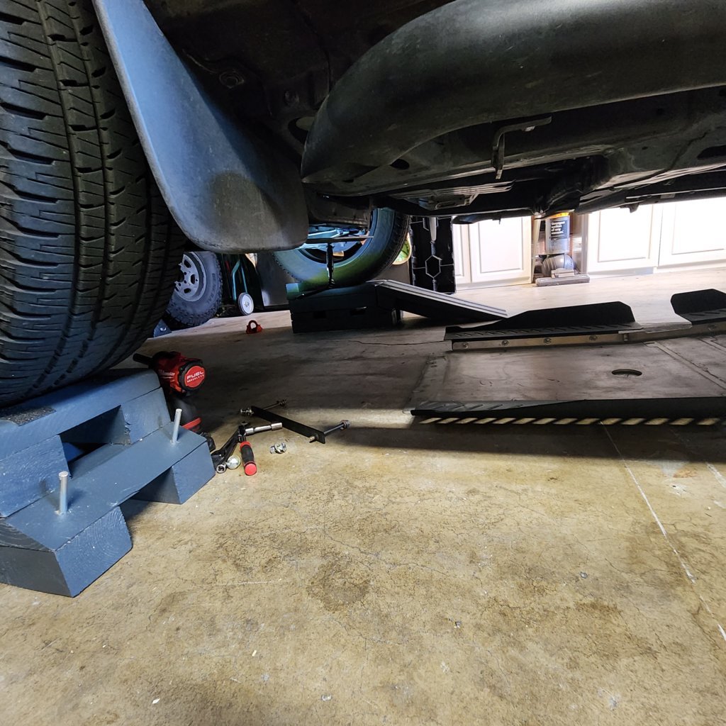

    Build yourself a set of ramps from wood. I have and used the rhino ramps and didn't feel 100% safe so I'd use Jack stands as a backup just in case.
    The wood ramps are much heavier but how often will you be lugging them around? I have built several for friends and family.
    My brother built me these which are far better then the ones I build.

    Bigger door= larger weak spot.
    primarily purpose of the skids is to protect. Secondary is making it easier.
    I originally left the door off as it was pretty easy to get to it from the side. We didn’t sell any. I added the door and boom they sold.
    As far as larger door, we could make it larger, but it doesn’t matter how large we make it it will never be large enough. It’s 4 bolts to remove the door, but at that point it’s also 4 bolts to remove the front skid….
