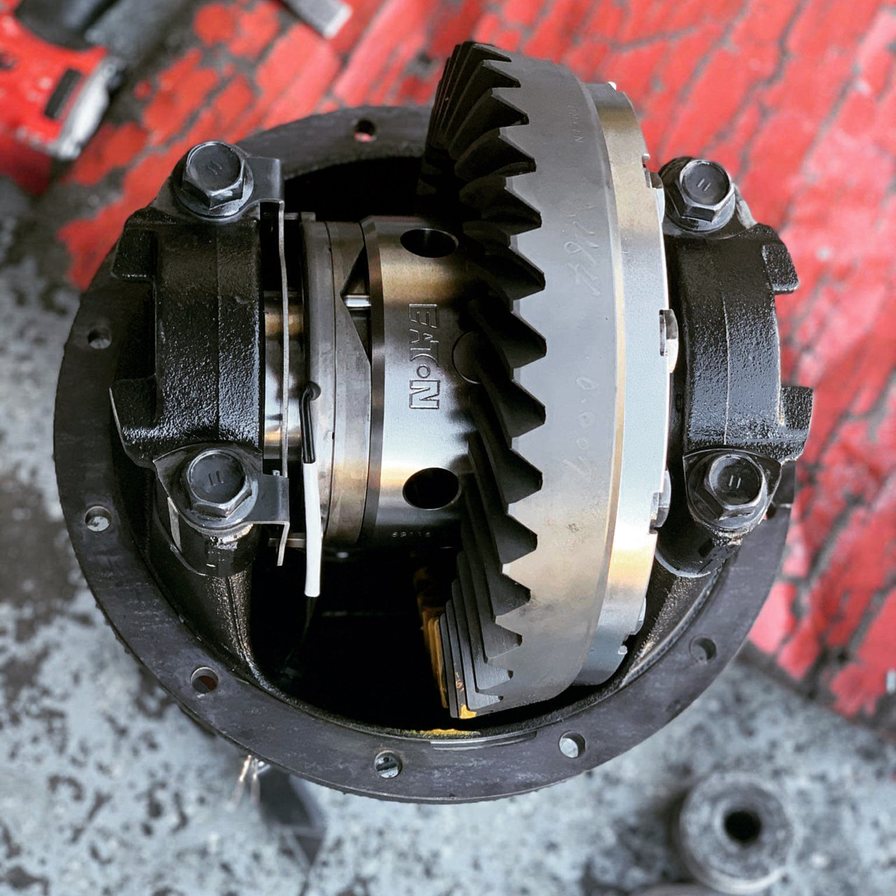

    E-locker would be easier if you do not want to rely on air

    Yes but not actually ready for full production. I have Harrop E-lockers in front and rear of my 2018. They are in a contract type agreement with Eaton USA in Dayton, Ohio which will be doing the distribution. There is another company that has "some" but want a lot of money for theirs (twice the ARB price) but that would surely not be the case when Eaton USA gets them in their hands.

    I was told last year when I got mine that they will be announcing the new addition to their E-locker line at the SEMA show and they did. There is some type of big agreement or contract they are in with Eaton USA that requires "all Australian production E-lockers for the new Tundra's" to go to Eaton USA for distribution. I was just told this morning by one of the boys down under that Eaton will begin distributing their ELockers later this year. No specific date was provided
