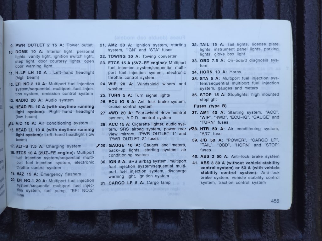

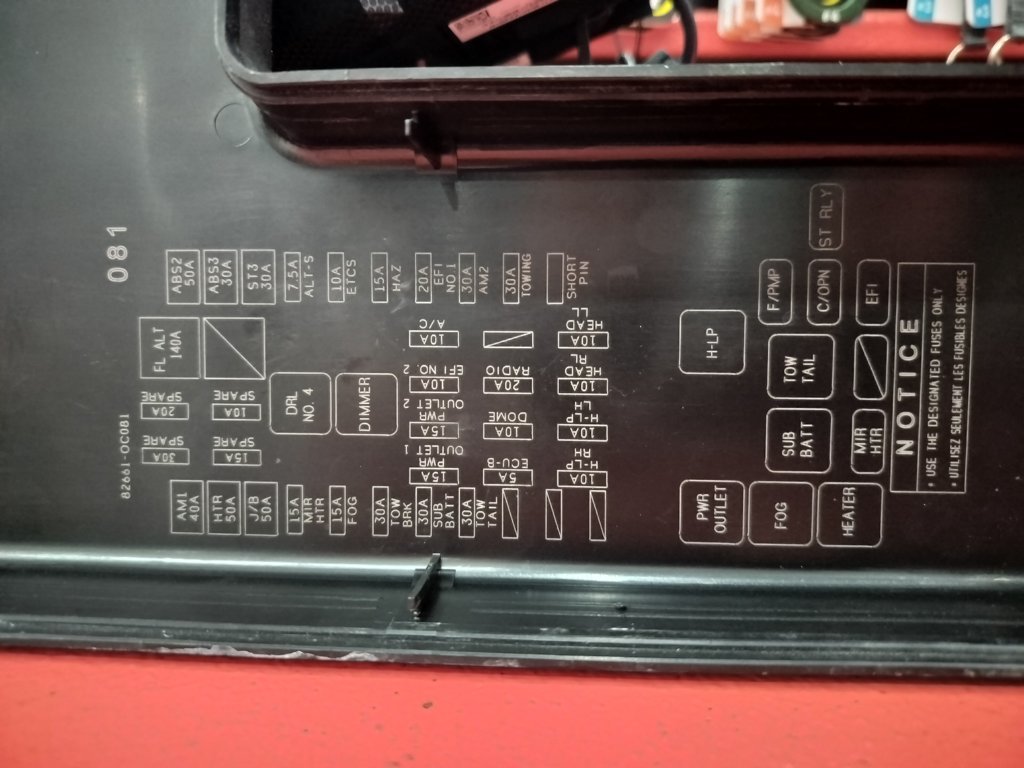

    What about the small fuse for the electronic throttle body/EFI. I was once jumping off a stranger and one of us accidentally reversed the cables for a brief instant. It was enough to blow that fuse. The Tundra would start, go into gear, and drive - but wouldn't go past idle speed.
    shifty` and The Black Mamba like this.
  11. Jul 9, 2025 at 7:26 AM
    TnPlowboy
    TnPlowboy New Member
    Nov 19, 2023
    #107178
    126
    2004 Tundra SR5 AC 4.7L 4WD, Tow Package: Blue Marlin Pearl
    I believe it was the 10A ETCS fuse that was blown...but don't hold me to it. In the 2004 version, there are 4 spare fuses in the engine bay, one is a 10A. I know your fuse layout is different with the SAIS and VVTi...but take a look in the pics below.
