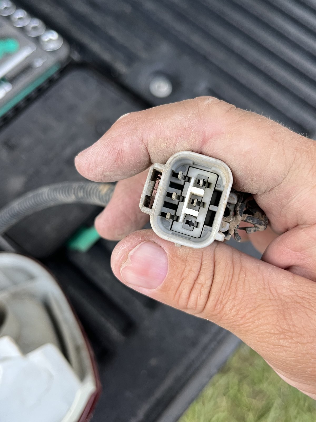

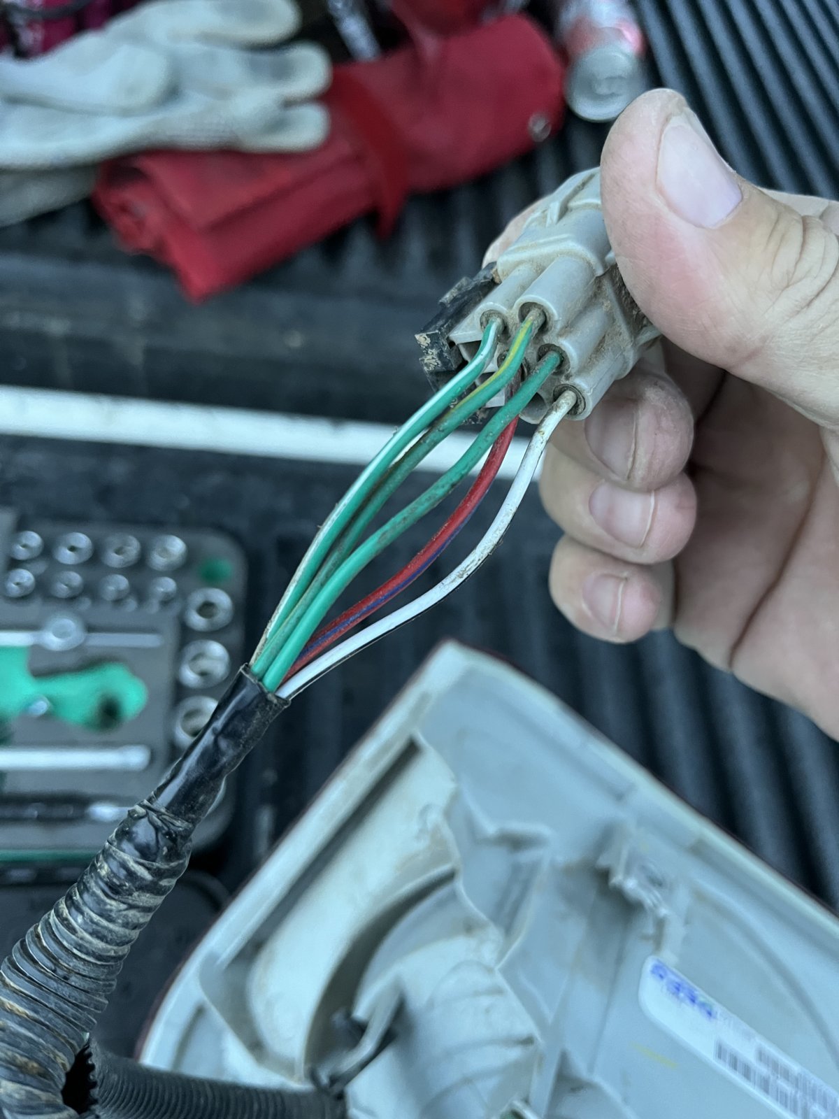

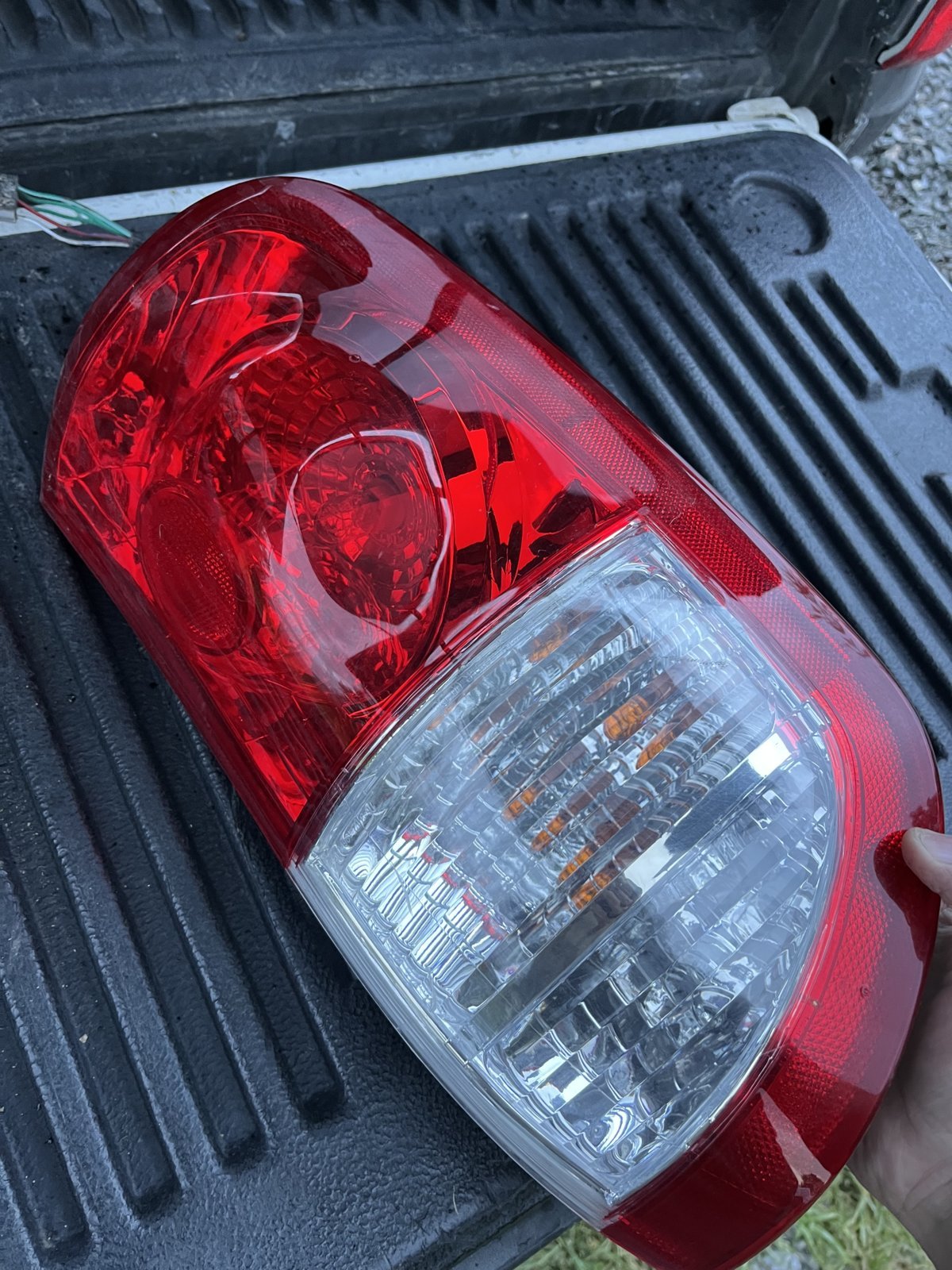

    I’ll upload a pic in a second but the only wire in my harness that has 12v when the lights are on is not connected to anything on the actual light. Maybe the incorrect year lights or something?

    Do you have tricolor lights? (Amber, red, white)
    Those are for older trucks and shouldn't be on yours (or my '06), and I'm not sure if the pinout is different, I'd need to reference the EWD. Got a pic of the housing harness?
    If that's the right light, and it loses power on your DMM when you turn the lights off, then ... you just need to figure out what's not making contact to the tail light line in the housing.

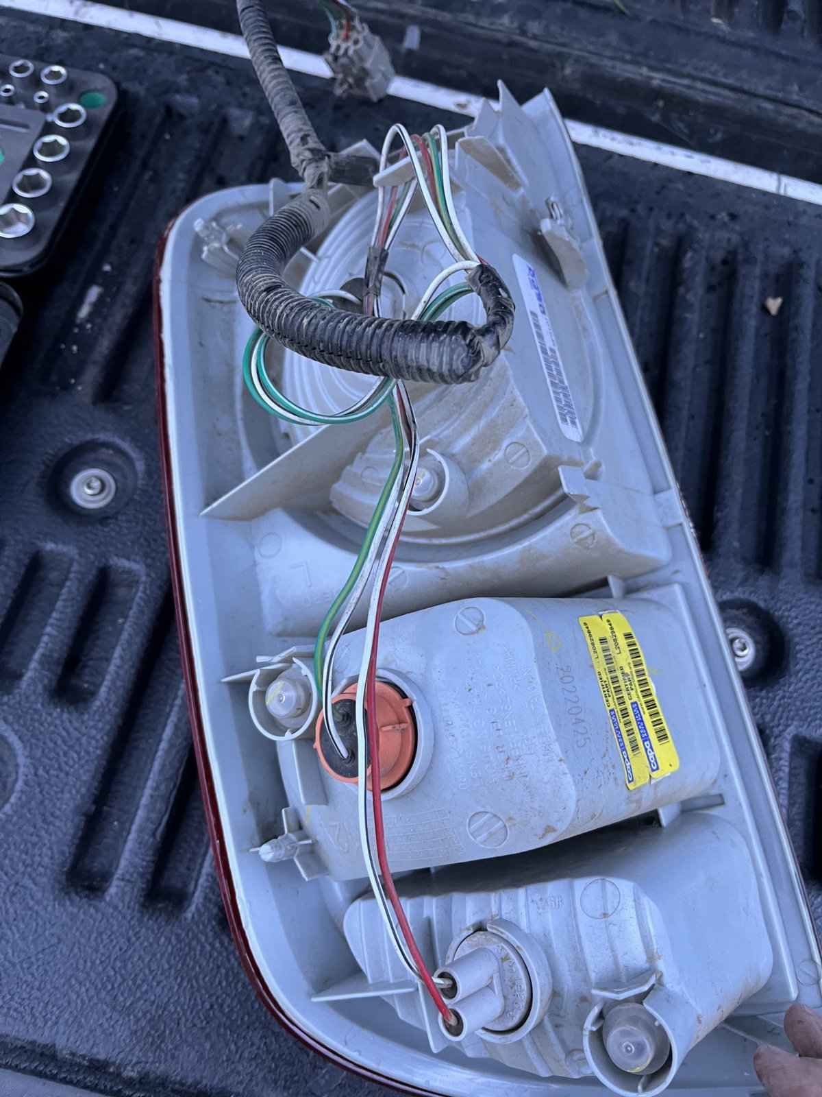

    It appears to be correct the colors match on the pickups harness as far as where the green wires are. The one I have with power is red. I’ll see if I can find where I’m losing power. I’ll try to check continuity to ground and see if is shorted somewhere. I tried unhooking the trailer light plugs and it didn’t make a difference.

    Those are CAPA certified DEPO brand housings, those are about the best aftermarket you can get and should be wired correctly.
    The wire colors I just gave you are for my AC, I just noticed you have a DC. I wonder if the wiring/colors are different for DC?

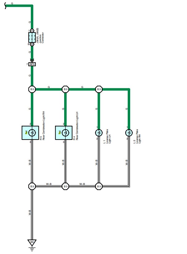

    I just pulled all the electrical diagrams and will trace down the fault after work, there's on plug on the drivers kick panel and one under the drivers seat that the power goes through prior to going under the vehicle. Hopefully it's something in one of those plugs, maybe something was pushed under the seat and pulled a wire. I will update the post once I figure it out. Thank for the help.

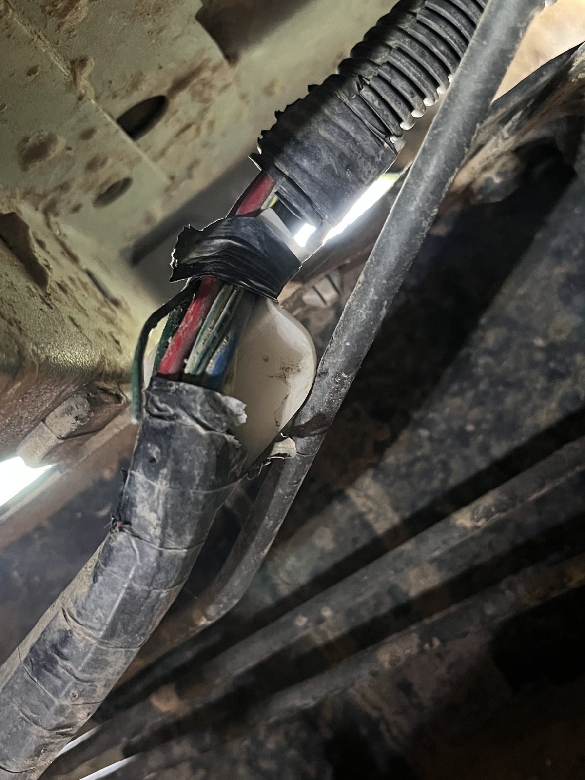

    Well I crawled all over under the truck with a fluke after the plugs in the cab all tested good. Ended up dropping the spare and found a broken wire where the harness splits by the fuel tank. I’ve worked 16hr days since Monday so it just been sitting waiting to be fixed but I plan on fixing it this morning. Hopefully that’s the only break.

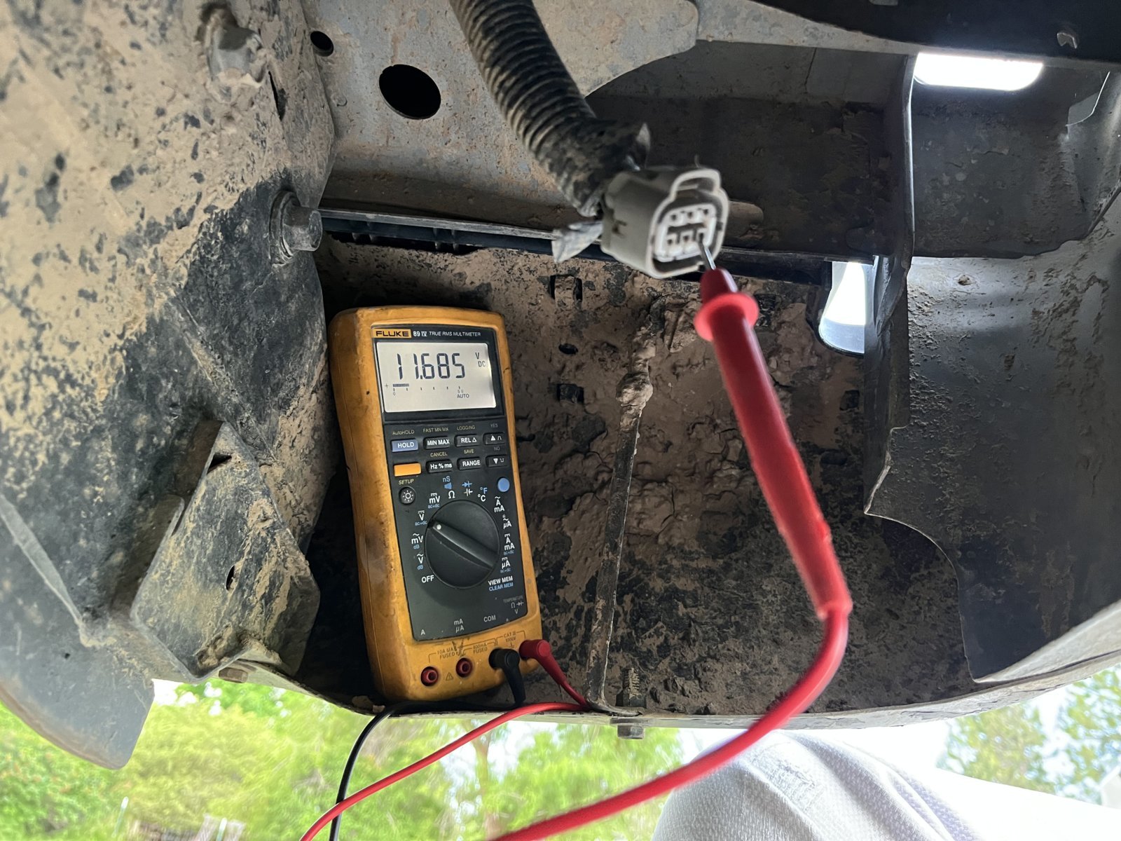

    As far as troubleshooting, I first used a 12v wire from under the dash and tested the tail light harness to verify all the lights were working properly. They were good so then I started testing the plugs inside the cab. I tested voltage but to verify the plug was good I used the same jumper and sent power to the frame harness. I was able to get brake lights and reverse lights to work but not the tail light. From there I pretty much knew it had to be a wire in the frame harness. I stared just under the cab and moved back a couple feet at a time where I could reach the harness and poked my fluke lead through the coating on the wire. I had power back to the tank but not behind the Y harness that drops wires toward the diff in the rear. I dropped my spare so I could access the Y harness and one side had power, the other didn’t. I pulled one side and felt like I had too much movement in the wire. I then pulled the front side and the wire pulled out about 2” from the end of the harness.
    It should be a quick easy fix.

    Good job.
    That looks to be a green wire and it is indeed a green wire for the tail lights.
    But I'd guess your license plate lights didn't work either?:confused:

    They were all out, but are all off of the same green power wire. It was a little difficult finding the J38/J39 plugs. The drawings aren’t great and the plugs right above them had a green as well. Once I’d figured out the correct green feed it was pretty quick and easy to find.
