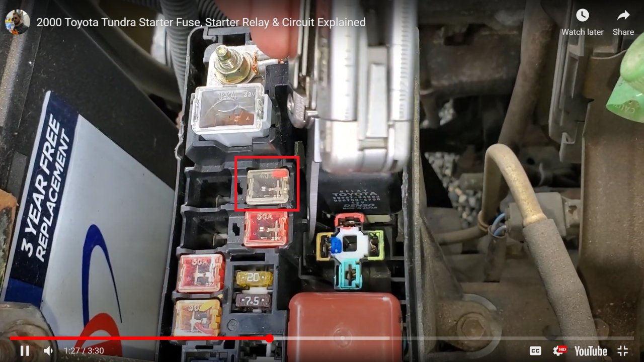

    This part is the reason I suspect this is a power delivery issue. I suspect it's either bad ground, bad power, or something shorted in the engine fuse/relay box like THIS GUY found. There's at least one other case where a member found the positive battery line going to the interior fuse box was shorting and not sending power to the cab. Too bad it's such a pain in the ass to pop the box up and look at the underside. It's not that it's difficult, there's just a trick and an order to it.
    This thread may be interesting to you for troubleshooting steps. I assume it's not the starter relay, but this post has a video that covers diagnosing that in our trucks.
    Electrical issues are the worst to debug, but there are wiring diagrams here at the site on a year-by-year basis that can assist with troubleshooting.

    That video helped out so much thank you issue fixed

    In case others run across this problem, what was actually discovered and the fix ?

    If you watch the video shifty sent there’s a 40A ami fuse in the engine bay that was blown that was keeping power from going to my key switch in the cab

    AM1 fuse

    That’s the one an I went ahead an replaced the 30 just in case but after that turn the truck on an found out my alternator was bad
