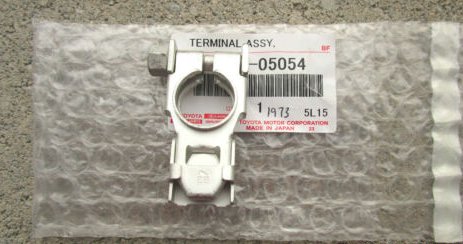

    Connector terminals...? Are you referring to the battery connection terminals? such as this: upload_2022-9-10_14-6-44.jpg

    Yea, also the body ground

    Have you experienced these connectors causing such a condition? It is defiantly something I can address. In addition to cleaning (wire bushing) the connections to the battery (both neg and pos). I also removed the Negative cable where it connects to the vehicle body. I wire brushed the connection area and re-bolted down the connection..... even though there were no signs of corrosion.
