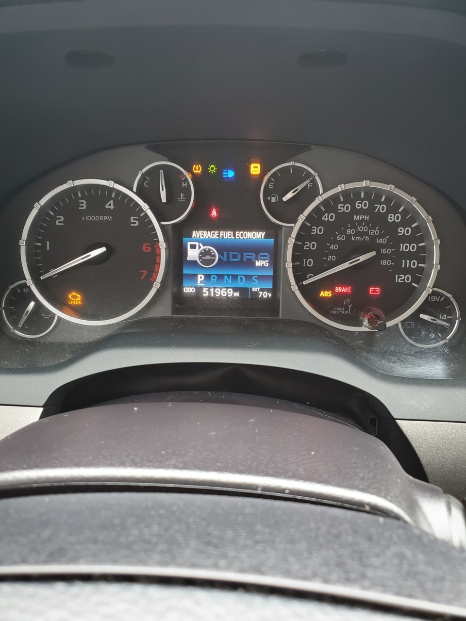

    I have 2017 Tundra. My headlight indicator and high bean indicator are lit up on dash, but lights are no working. Also I have tire pressure waning light flashing, anti skid light on 4Lo/4Hi flashing. Abs and Brake lights are on. And on top of all this I have speedometer /odometer. And I have to use the bypass to get it out park. I'm guessing I need to take it to the dealer. I bought it used and everything was fine until yesterday

    Every contact point is extremely clean. These lights are on while it is running except for the battery light. My bad, realized the picture had the battery light on
