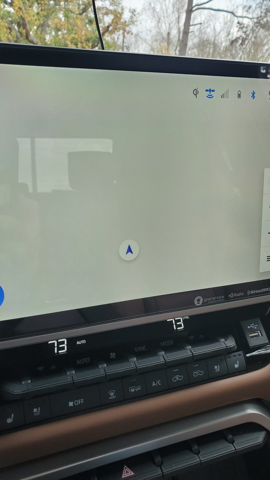

    Yesterday and today I noticed no road details in my info screen. Why? I rebooted several times but still no road information. Any help sincerely appreciated. See attached pic.

    Reboot it, hold down volume knob

    I did exactly that 3x to no avail.

    Any change when you zoom in or out?

    Here's a stupid question, is your subscription current? As the Toyota mapping is pay to play basis. Should be complimentary only for 1 year from Toyotas documented "date of first use". Does your smart phone mapping come through in Android Auto or Carplay?

    2023 tundra was bought new 06/09/23. 5000 miles so far. Subscription still free till next June. Doesn't matter if I zoom in or out...no roads. It was working 2 days ago.
    Android auto works but I prefer the Subscription since it's free for now. I'll put this on my list to fix with dealer warranty stuff.

    Mine did that once and stayed like that till I got to my destination 15 minutes later. When I restarted the truck it was back alive and never did it again

    I'm on my way home from Xmas w/inlaws. The road info came back briefly, 1 hour, then went blank. Then the program destination to our hotel was erased when it was recalculating the route....over and over. I rebooted while driving then it asked for my PIN number several times. OMG.
    Then it erased all of my saved and sent to vehicle settings. I ended up asking destination assist to send directions to us for our hotel. It did so and we arrived ok.
    Definitely a trip to the dealer next week. What a cluster.

    Well, tech said I had the latest update. Can't believe what he told me about the blanked out areas. He literally said to use a more reliable app for maps such as Apple Car Play, waze or Google maps. That was their solution. Did get the recall done, although it says it's just an interim fix.

    I'll let you know what my tech rep says when I bring it in next week. I still have no road names when in use. I certainly did before. Android auto works fine but I don't always want to use it. This at least confirms I won't be buying the subscription service when it expires.

    Toyota tech recommended I call SOS ask for connections services to walk me through this issue. I replied, no, I'm bringing it in to document this issue under warranty and you can run a diagnostic on it. Then and only then you can call me crazy.

    That's actually the better way to go. I've read elsewhere SOS is able to remedy alot of issues vs the dealership.

    I'll give it try and see what SOS connection services says. My trial subscription doesn't expire tii next June 2024.

    Gray Hawk... I'm having same issue with my Tundra. I get details on streets in some areas and then the roads disappear from the map. It was uncanny because the navigation system would direct me through the turns but the map wouldn't show the streets. Took it to the dealer today and was told that the system was functioning properly. I was a little perplexed... so the maps aren't supposed to download consistent? Seriously, that's the answer from the dealership. They said they filed a report with main Toyota. I refused to sign for the truck and asked them to test the map function in another truck to see if it's just the area not showing and it's a flaw in map design or whether it's just the head unit for my truck. Still waiting to hear back on that. Would like to know if you had any luck with the SOS tactic. Just wanted to let you know that you aren't the only one with the issue.
