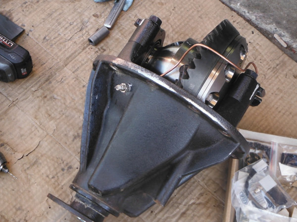

    I have the ARB air locker. i would highly recommend it.

    1,129
    2018 Platnium
    is that aftermarket? sorry i'm new at this..

    No completely aftermarket. I want one!

    very aftermarket

    i prefer the ARB because i can engage and disengage it at will.

    No, the ARB is an open differential that has an air activated device in it that locks both wheels together. With it both wheels have to spin (at the same speed). It's the best option of you are into serious off road driving as when you hit the pavement you can turn it off. If you're looking for some way to stop one tire from spinning when leaving a stop sign if you step on the gas a little too hard then you would want the Auburn. One option would be to put the Auburn in the read and the ARB in the front. A compromise to get better traction for normal driving yet get good traction off road.
