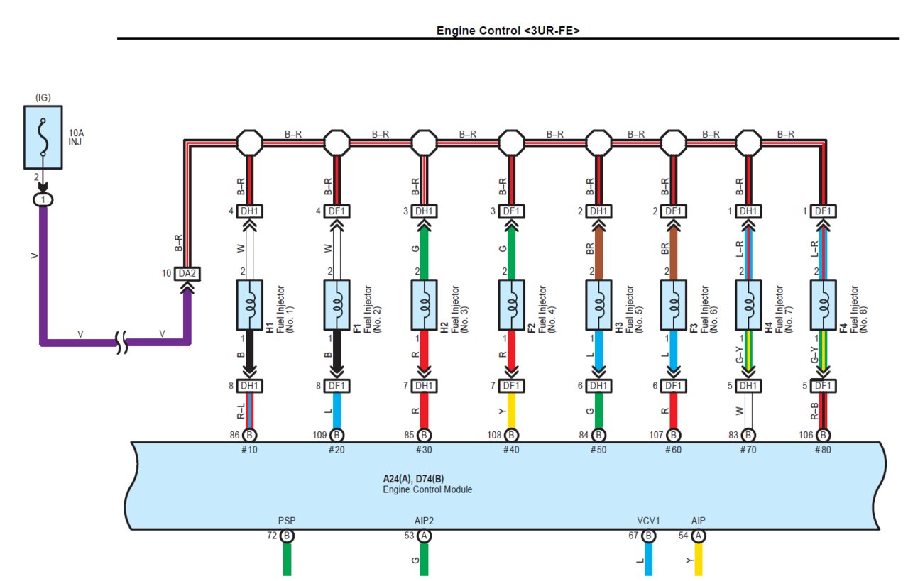

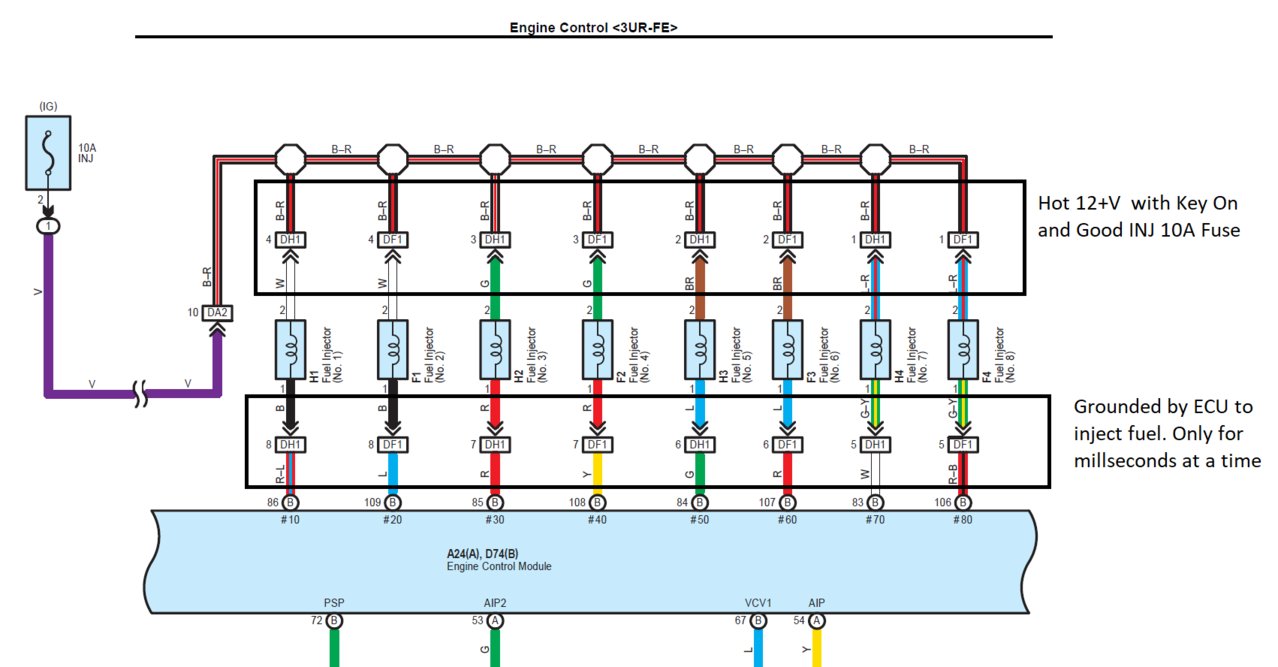

    The injectors has a two legs, one is hot 12+v all the time, the other leg goes directly to the Engine ECU. The ECU grounds the second wire for a determined amount of time to power the injector and inject fuel.
    First make sure your fuse powering the injectors is good. Then get a voltmeter, one lead to the 12v leg of the injector, the other to a good ground. Make sure you have a good 12V at each injector with the key on. If you do then all you need is the ground signal from the ECU to flow fuel.
    I would also check every fuse in the truck. Some are tired to other circuits and relays that power things like the Fuel Pump ECU when the key comes on.
