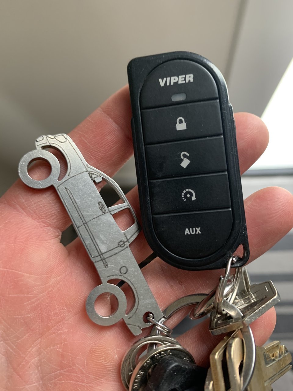

    Me again. So ever since this episode the markers haven’t been flashing when I lock/unlock the truck. They flash with the factory key fob but not when I use the Viper starter fob (which is my main fob). Anyone have any ideas?

    Look for fuses inline to your viper module, or on the viper module itself.

    All the Viper fuses are good o_O:(
