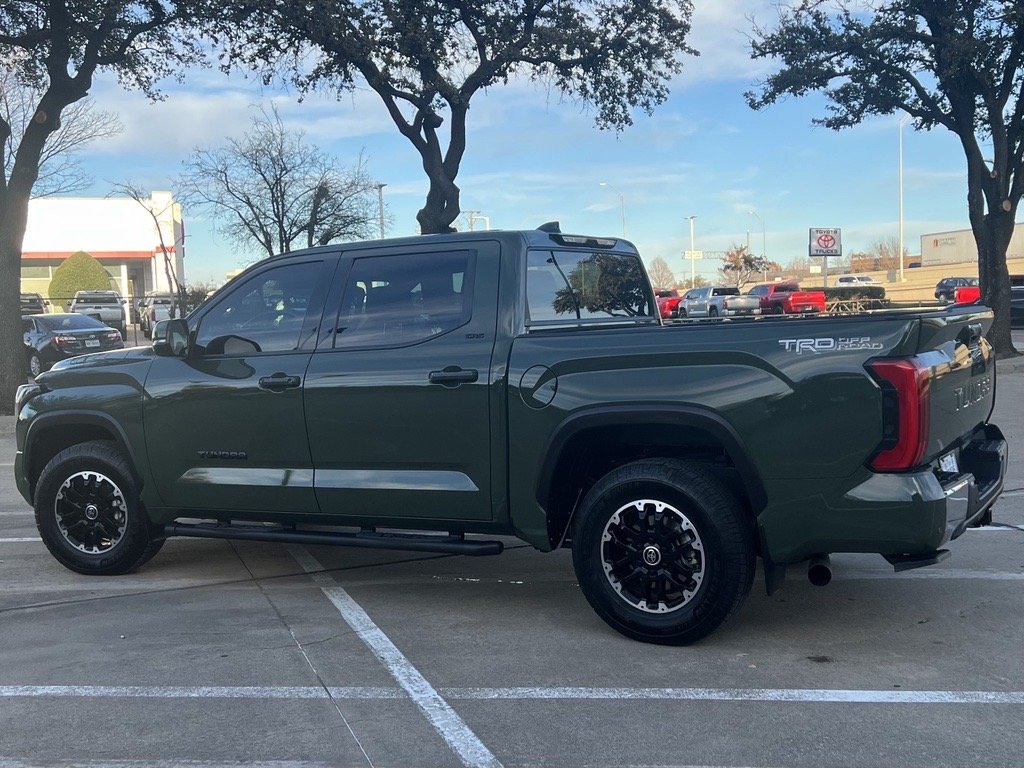

    Hi all,
    I am wanting to lift my recently purchased 2WD 2023 Tundra SR5 via. However, I've had trouble finding ANY available lift methods that aren't a spacer/puck lift. I want something long term and sustainable, but I can't find anything. The answer I keep getting is that my truck isn't compatible. Can't do Bilstein 6112 or 5160s either.
    Any recommendations aside from Westcott?
    Thank you,
    bransull

    The Dobinsons front coils just aren't rated for a 2WD and on most IFS Toyota's in the past, a 2WD lifts about 1" more with a 4WD coil in it. So a 2" 4WD coil lifts 3" on a 2WD, but there can be some variances.
    But I don't know anyone that has tried any of them on a 2WD yet, so the results are unknown. And pretty much all brands would say the same thing if they haven't been tested.
