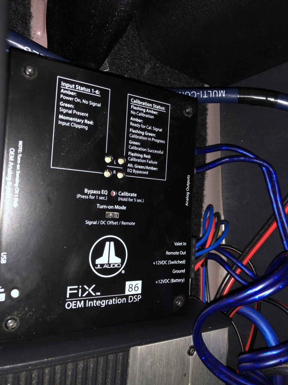

    I’ve had my fix 86 dsp now for about 5 years. Transferred it from my taco. Today when driving into work I lost all sound to both speaks and sub that connect to it. I looked everything over I could and don’t see an issue. Has anyone experienced this or similar. It’s just one blinking light. That appears to indicate a calibration is in progress?
    video and pic attached
    not sure how to upload video says file doesn’t have allowed extension
    it’s the upper ‘L’ left light that flashes green or possibly amber not really sure what color to call it

    Says amber means power on, no signal. Is there a chance a wire somewhere vibrated loose?

    no don’t think so. End up calling tech support, they said that wasn’t blinking a code, that it wasn’t normal and there’s a good chance something internal went. Tried resetting it to calibrate again while on the phone with tech support and it would even go into calibration mode. So I’m sending out for repair. About a third of the cost of a new one.
