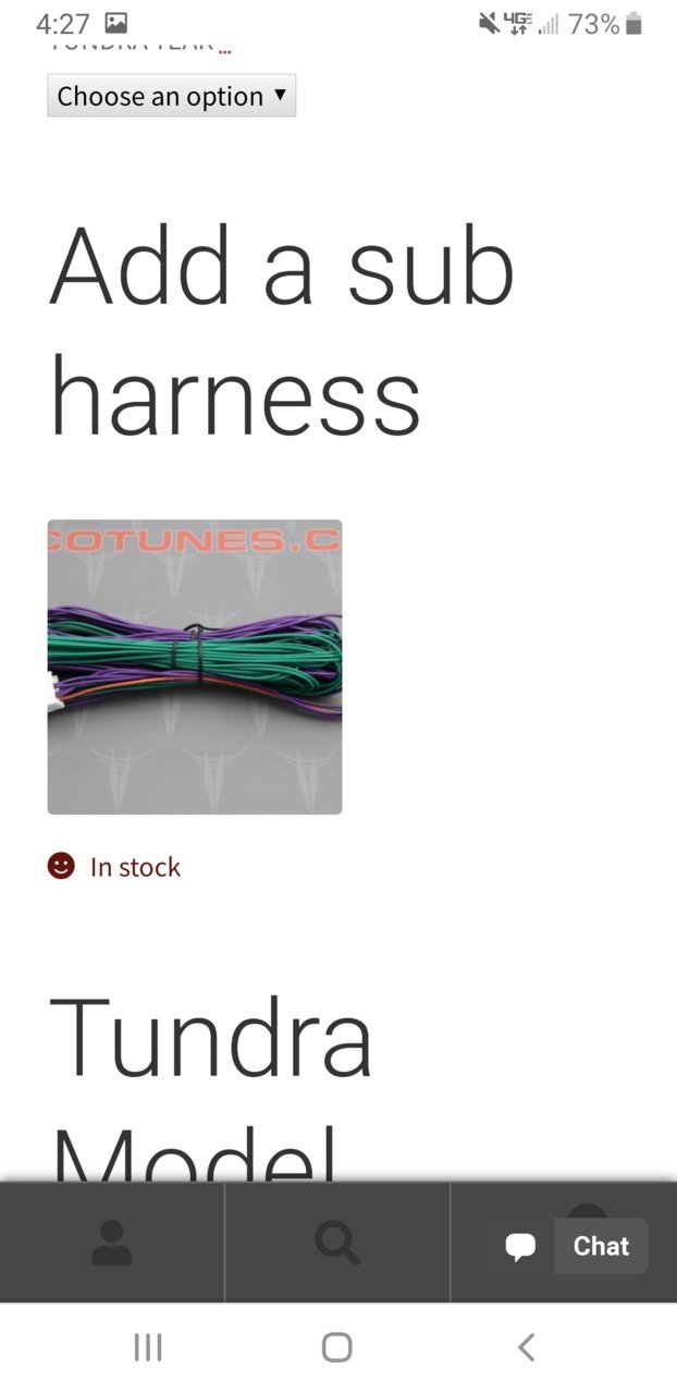

    Taco tunes has a plug n play harness to run to the amp you're adding.
