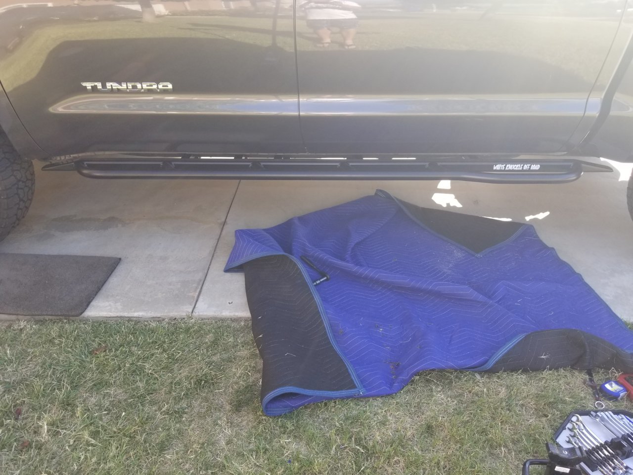

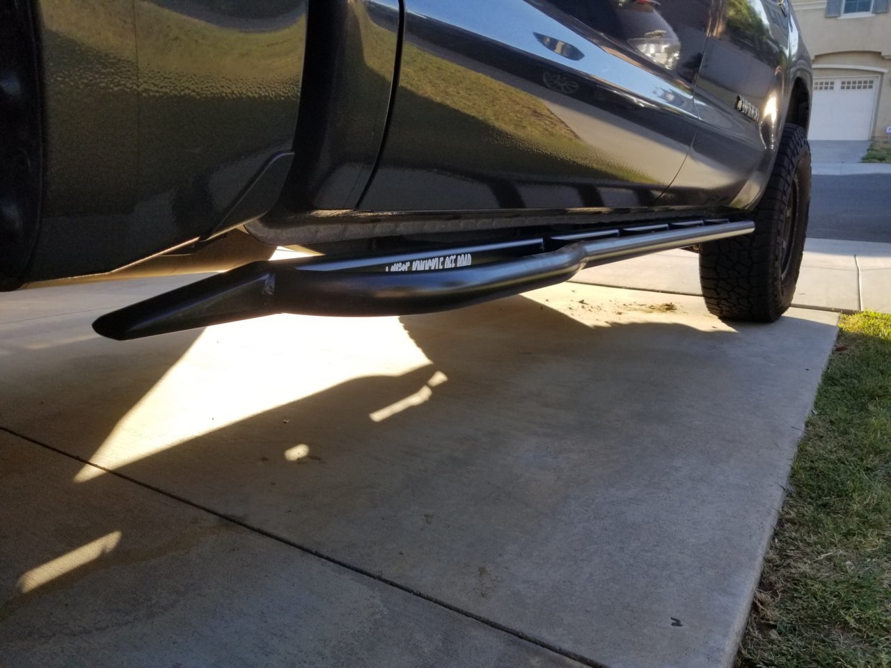

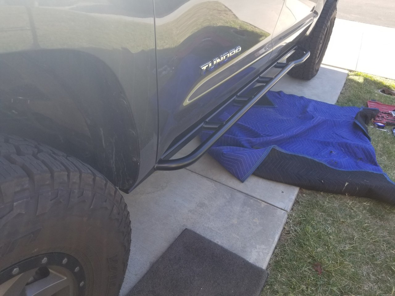

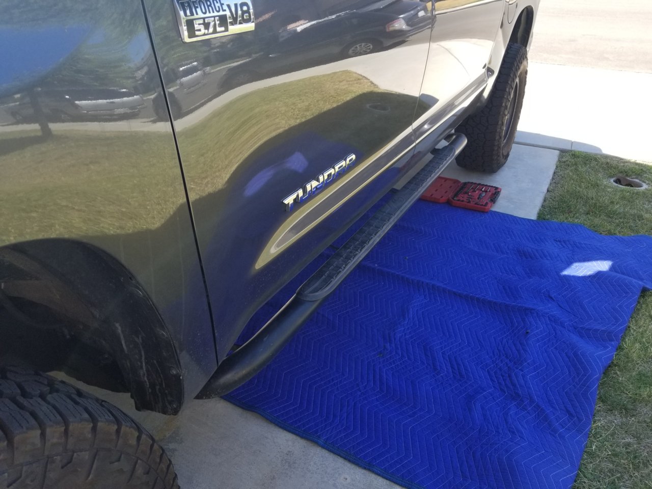

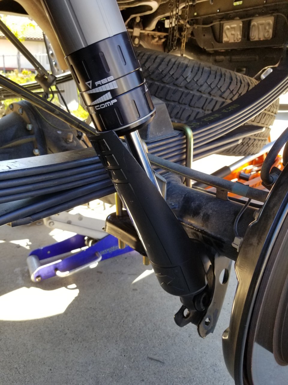

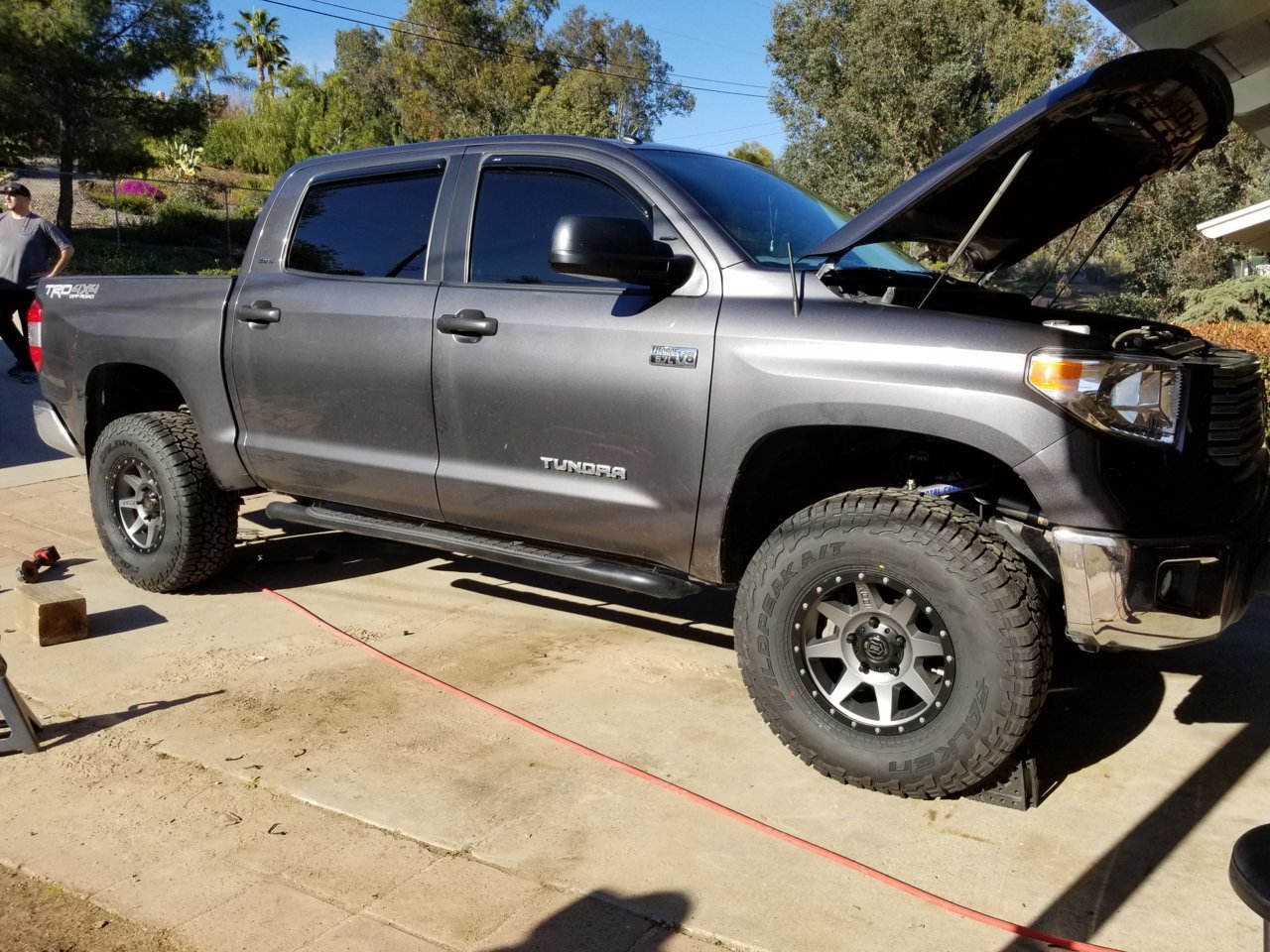

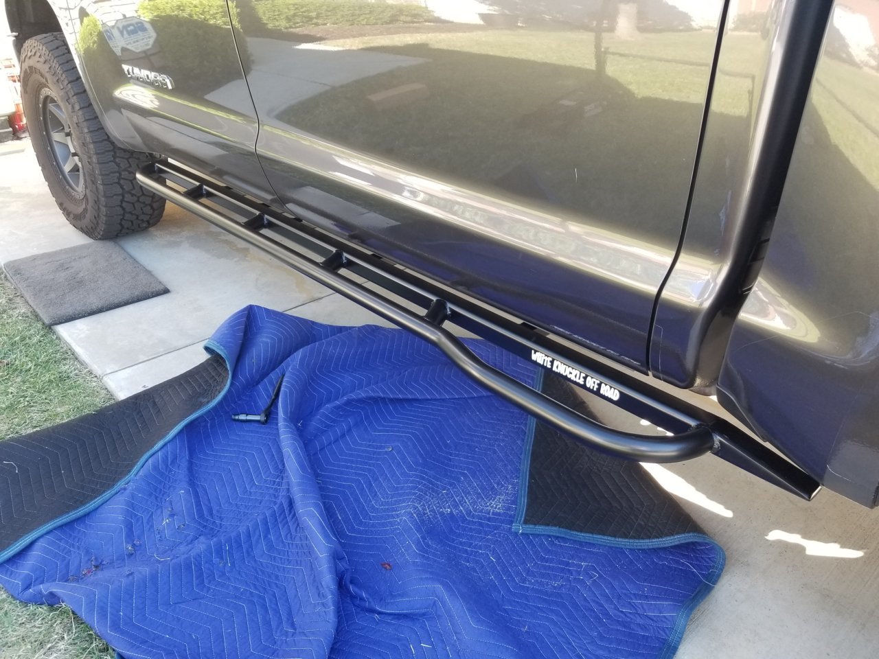

    Finally got around to "starting" my slider install.

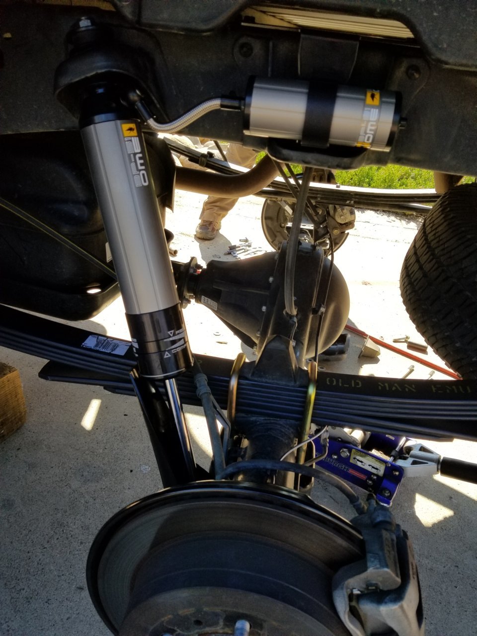

    I really like the suspension. I have not taken the time to dial it in yet (me being lazy)
    The rear has settled to almost even with front due to towing.

    Edited 1st post to show sliders.

    I still need to drill bottom holes :(

    Make sure to get a nice drill bit!
    My red taco I had a generic bit, and it took forever! ~one drill battery per hole.
    This go-around I invested in a good drill bit, made it ~one drill battery per side. Cut much faster and more efficiently.

    Plan on making starter hole before final size. And have extra bits on hand; I think we broke at least two before we were done.

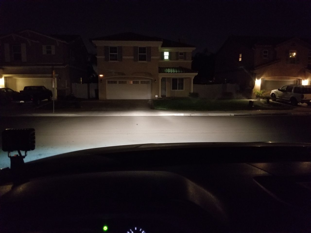

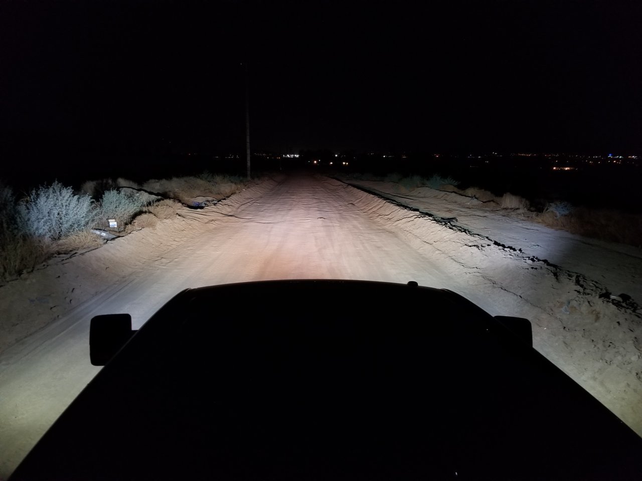

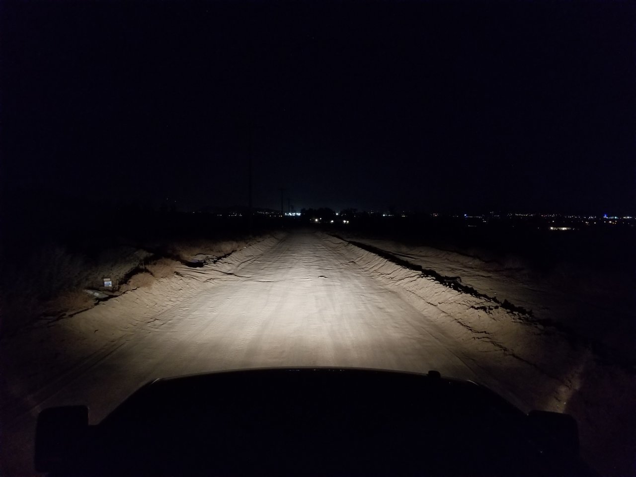

    Installed @Caliraisedled side projecting LED pods
    Running lights only for brightness reference
