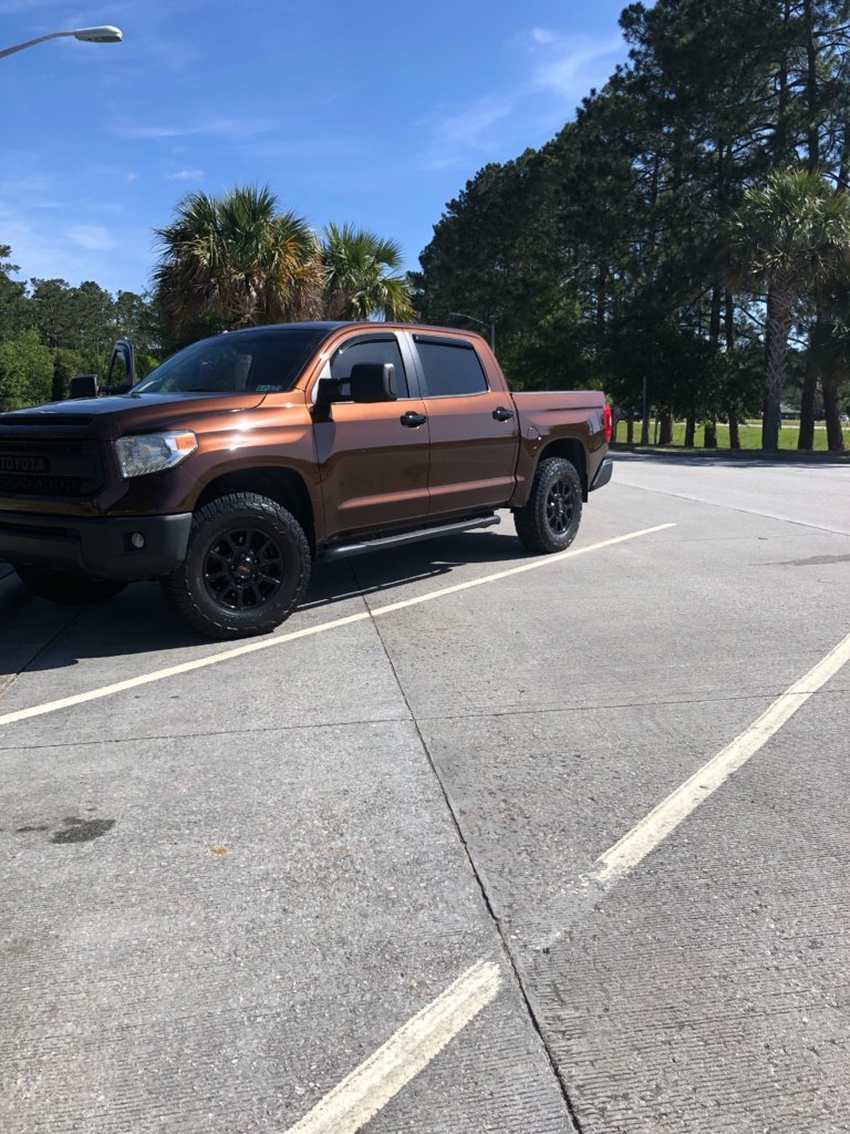

    My truck has the adjustable 5100 Bilstein Shocks on the front and rear with the front set on the middle setting. I want to possibly get a little more lift and maybe change my tires to get a little bit beefier look. It is leveled but sometimes it looks like it has a rear rake since I have the camper top. Looking for options to get another inch or so of lift without having to change steering components or ruin the geometry of the front end. My tires are 275/70/18 on stock TRD wheels. Should I just move to top setting in the front and add a block in the rear?

    With the camper shell on, if you put the fronts to the top setting you will be nose high.
    Doesn’t look like you have any rake.
    If you touch the front, you’ll probably have to address the rear with something in the 2” range to keep it level.
    FYI on the set up you have you can fit 285/75/18 (35x11) on those OEM wheels and gain a much beefier look.
    Maybe do the tires first before tearing apart front and rear suspensions.

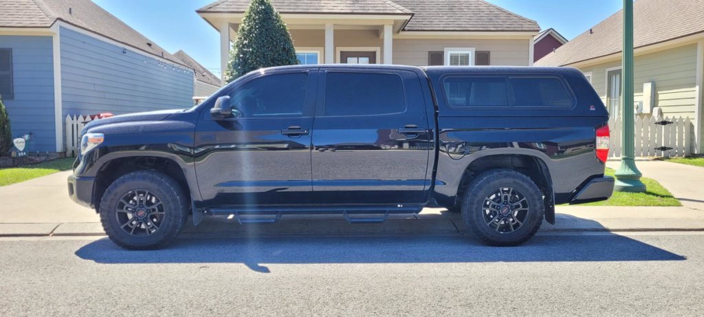

    Just for reference…
    285/75/18 factory wheels (same offset and size as yours) 5100 middle setting.

    Looks fine to me just as it is. :thumbsup:

    I think it looks great! Seems perfectly level.

    I think the truck (as it sits currently looks really good) :thumbsup:
