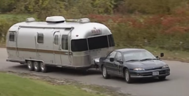

    You can probably make this safe and legal but you will be running near max axle capacities. Your rear springs are going to be the weakest link. That is an easy upgrade. There are a lot of tundras pulling 25 and 27ft airstreams and seem to do it well. The rounded shape really does make a huge difference when it comes to cross breeze and semis. You are going to want to invest in a very good weight distribution hitch with sway control.
    This was towed 120k like this. Hensley/Propride hitches are pretty amazing.
