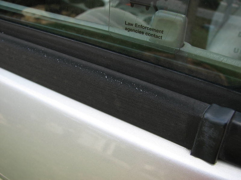

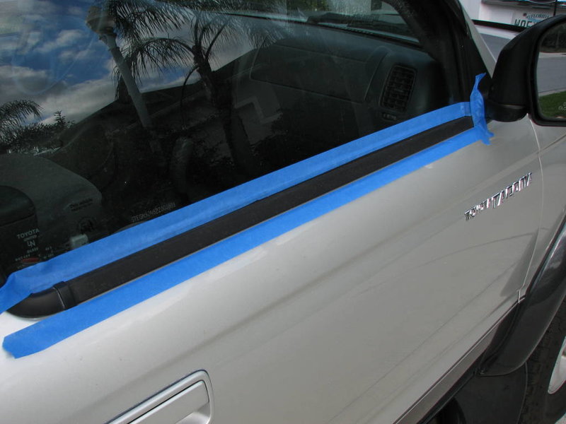

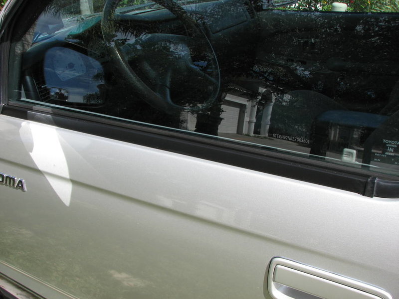

    I used PlastiDip on my Tacoma. It was easy and I got several years out of it for a $6 can.
    The only thing with PlastiDip to keep in mind: One of the things that make it a good option for spraying badges, is that it does not bridge the gap between the badge and the truck, so it is easy to peel the overspray around the badge without peeling the dip off the badge. This same property makes it bad for spraying a cracked or peeling part such as the window strip. The dip will not fill in gaps and cracks. I sprayed a first coat and used my finger to work it into the small cracks, then sprayed the rest of the coats over that.
