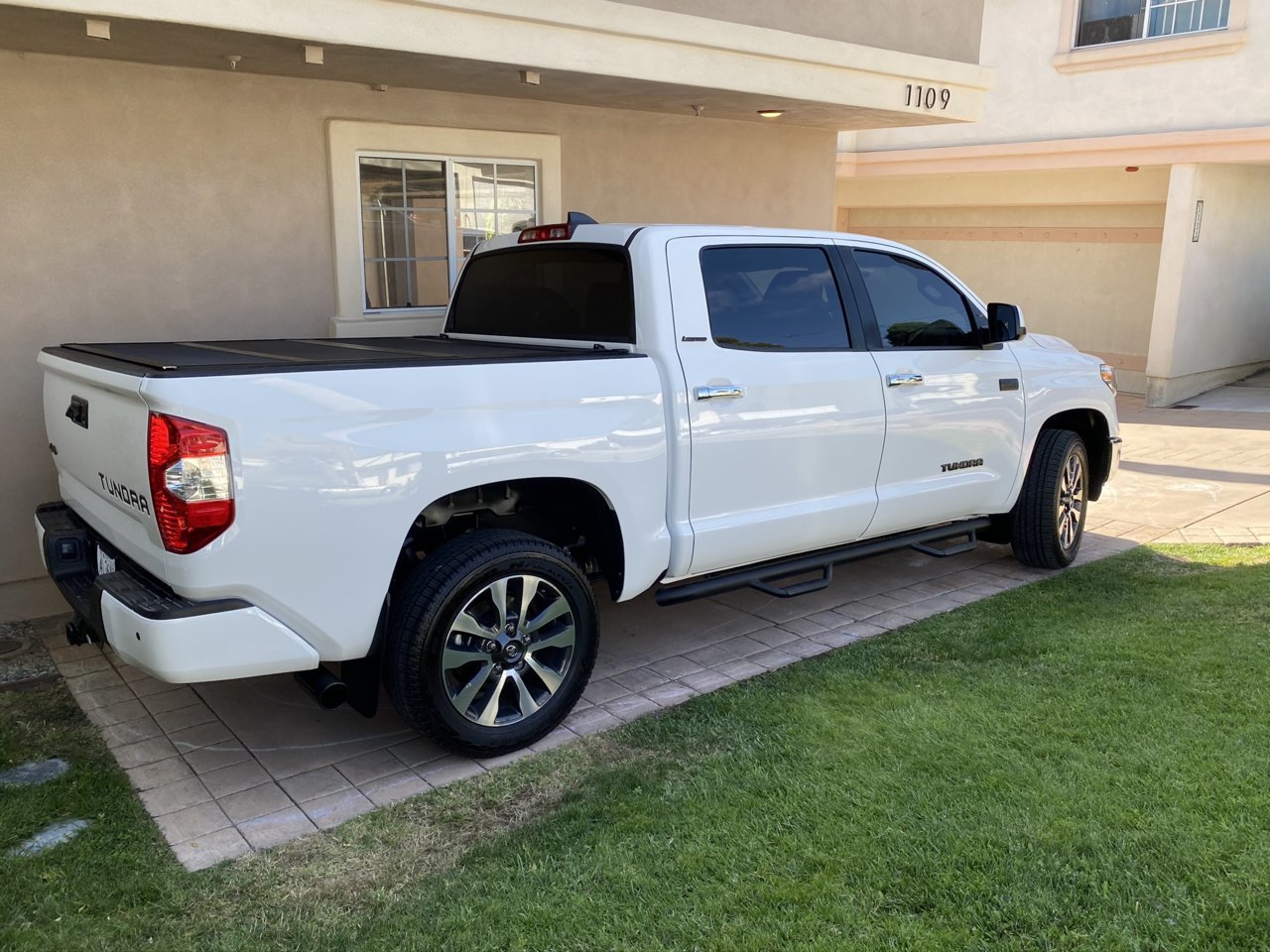

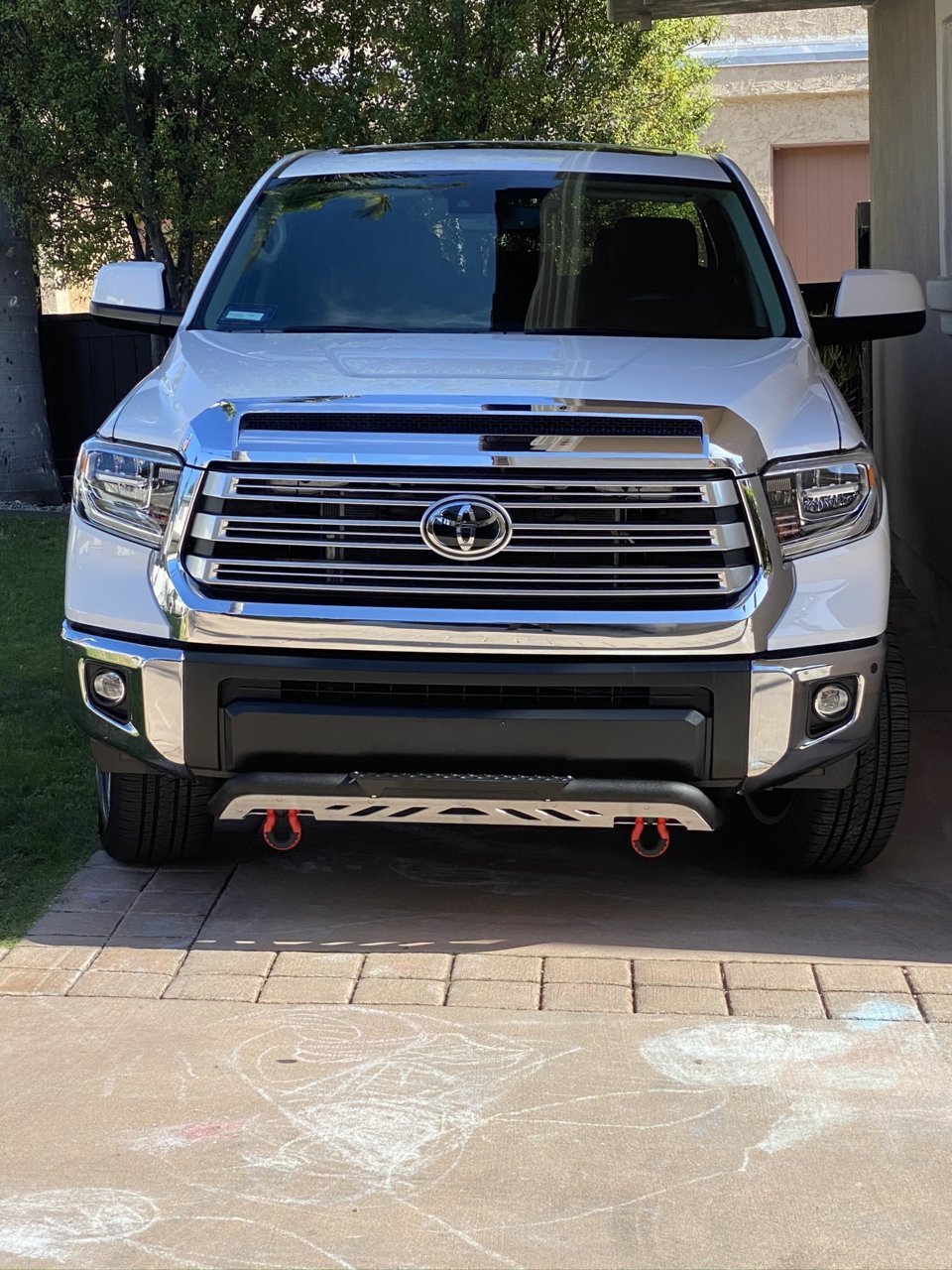

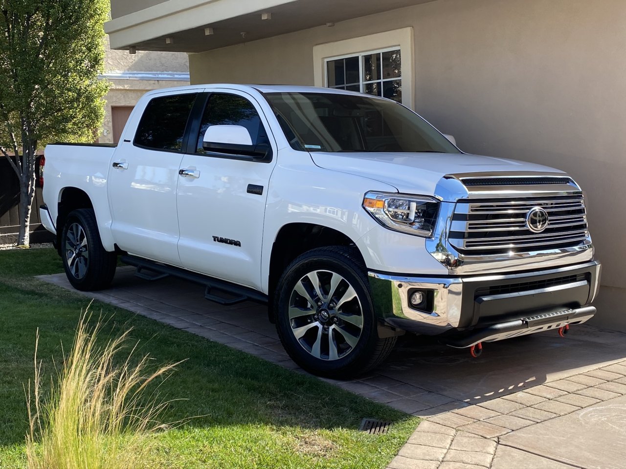

    First off, awesome forum, thank you for all the amazing info.
    I also have searched and searched but seem to get different answers every thread.
    So here it go’s. Just bought my first Tundra brand new two months ago. CrewMax Limited 4x4 and love it. Never owned a truck but always modded my cars so lifting is so new and confusing. Here are my questions, please be nice, lol.
    I trailer a 6000 lb boat regularly and long distances relatively often. LA to Havasu and back @ 6 times a summer. I don’t off road and it is a daily driver though not many daily miles as I work from a home office. I want to level lift the front 3” and want to lift the back 2” for looks and to keep some pitch for trailering. What is my best/safest options for the rear lift. I’d like to keep it inexpensive if still safe and not sacrificing too much in ride quality. Any other helpful mod recommendations welcome. 3B3766D0-143B-480D-B8A1-F40C00FD061B.jpg 840E4116-F35E-4FFB-9A05-768FC05E58B7.jpg 8799ED0A-A7FF-4161-AFD4-4FD6A6B5E344.jpg
    Next step would be to stuff the largest wheels/tires under it considering the trailering.
    Any opinions, advice, welcome as I am learning but keep seeing contradicting info.
