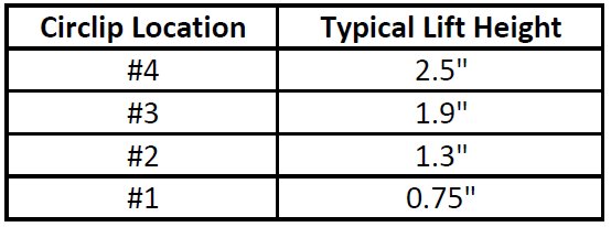

    I've seen that chart to Winning8, but then one day I noticed the Tundra Bilsteins only had 3 circlip positions...

    Thx bruh, maybe that’s for the 6112… I’m still deciding which one I should go for…

    Just checked out the 6112s, yes, they have 4 circlip positions. If you were thinking of going that route, I'd see if you could stretch that wallet a hair more and check out the Toytec Ultimate pre-assembled.
    The 5100s/6112s are fine shocks, but I'm a little jaded on the circlip adjustables. Its a very rare case, but I'm one of the poor bastards that got a damaged spring perch on my 5100s and it kept breaking circlips. Getting replacements right now is almost impossible, I even talked to Bilstein corporate and they told me maybe Oct/Nov on part lead times. I wouldn't let my bad luck skew your choice though, from what I researched, its a very rare problem, I just think the toytec ultimates are a nice combo of adjustability, price and looking SICK :D
