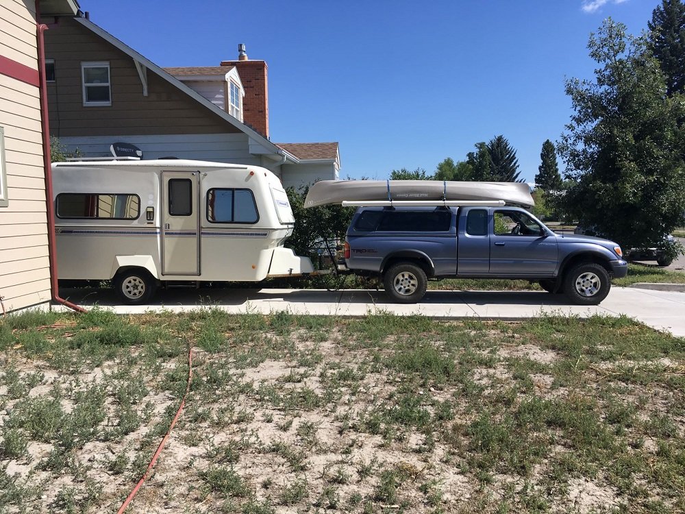

    Nice Bigfoot! I hope to have a photo soon of my new '02 Tundra pulling it.
