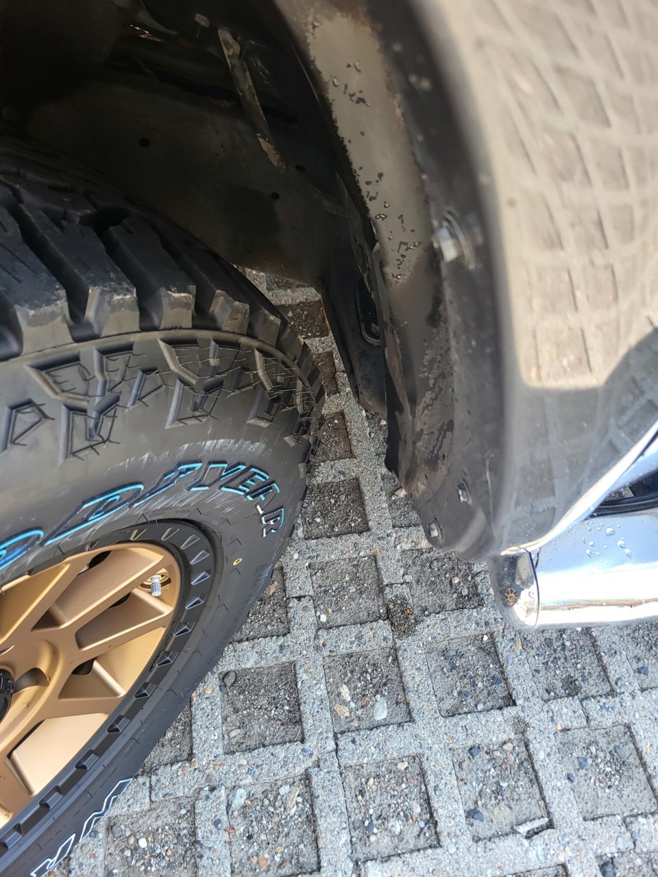

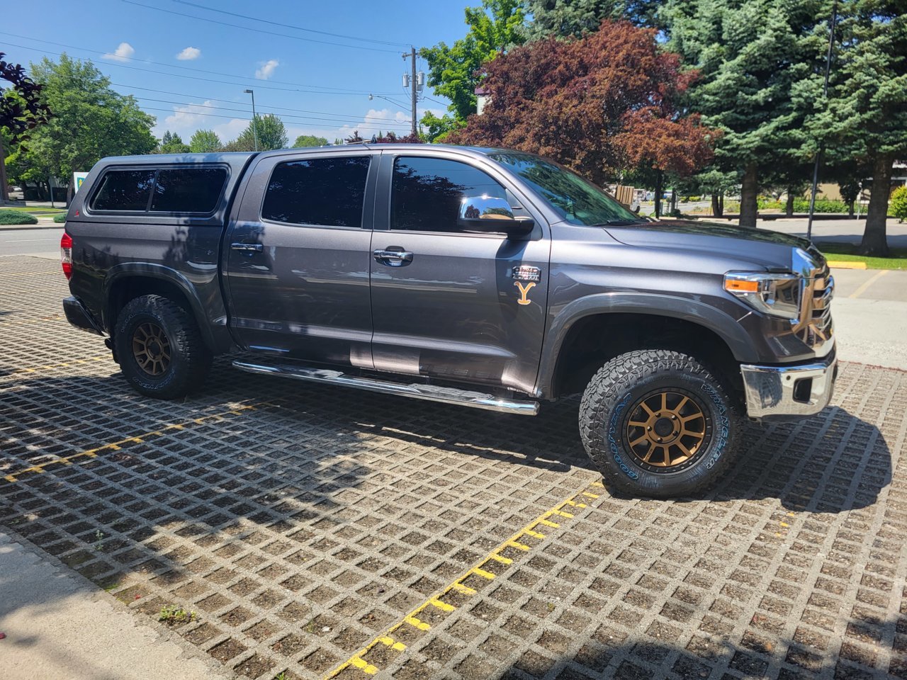

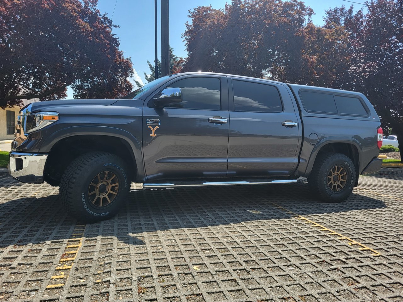

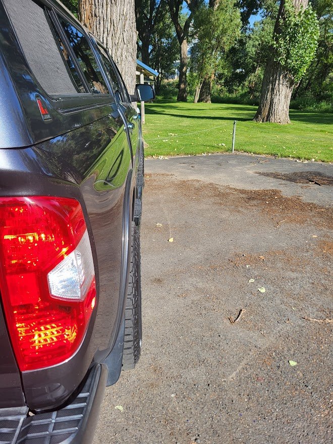

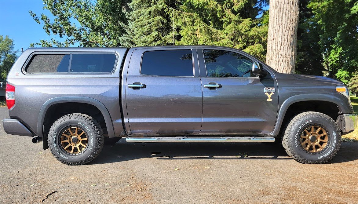

    2021 1794 Edition with Bilstein 5100s on highest setting.
    17x8.5 rims with +15 offset. 285/70R17 Goodyear Wrangler UltraTerrains.
    No rubbing or trimming.

    I have those tires in a 275/60/20 and I've been very happy with them...
    Looks nice...:thumbsup:

    Got it home and unloaded the 300 lbs of wheels and tires from the bed and she now sits perfect. Very happy with the performance and look. PSI is at 45, smoother than the factory shocks and 22's. Gas mileage was the same coming home as it was going up. 200 mile trip.

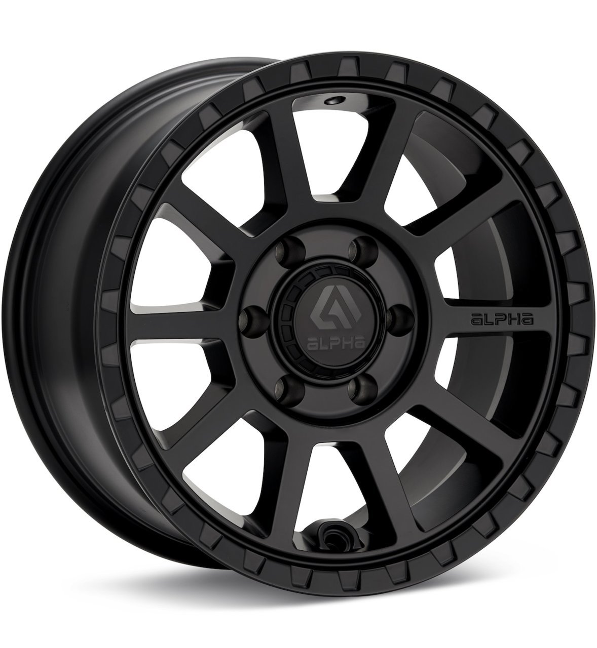

    thanks for posting this - I just ordered these earlier today as they were listed as discontinued and only nearly 50% off online with free shipping. I ordered the black ones for my silver sky colored Tundra! My appointment to get new tires mounted and installed is next Saturday morning. I'll have to post an update after I get mine. The interesting thing is that mine were listed as +35 offset :monocle:

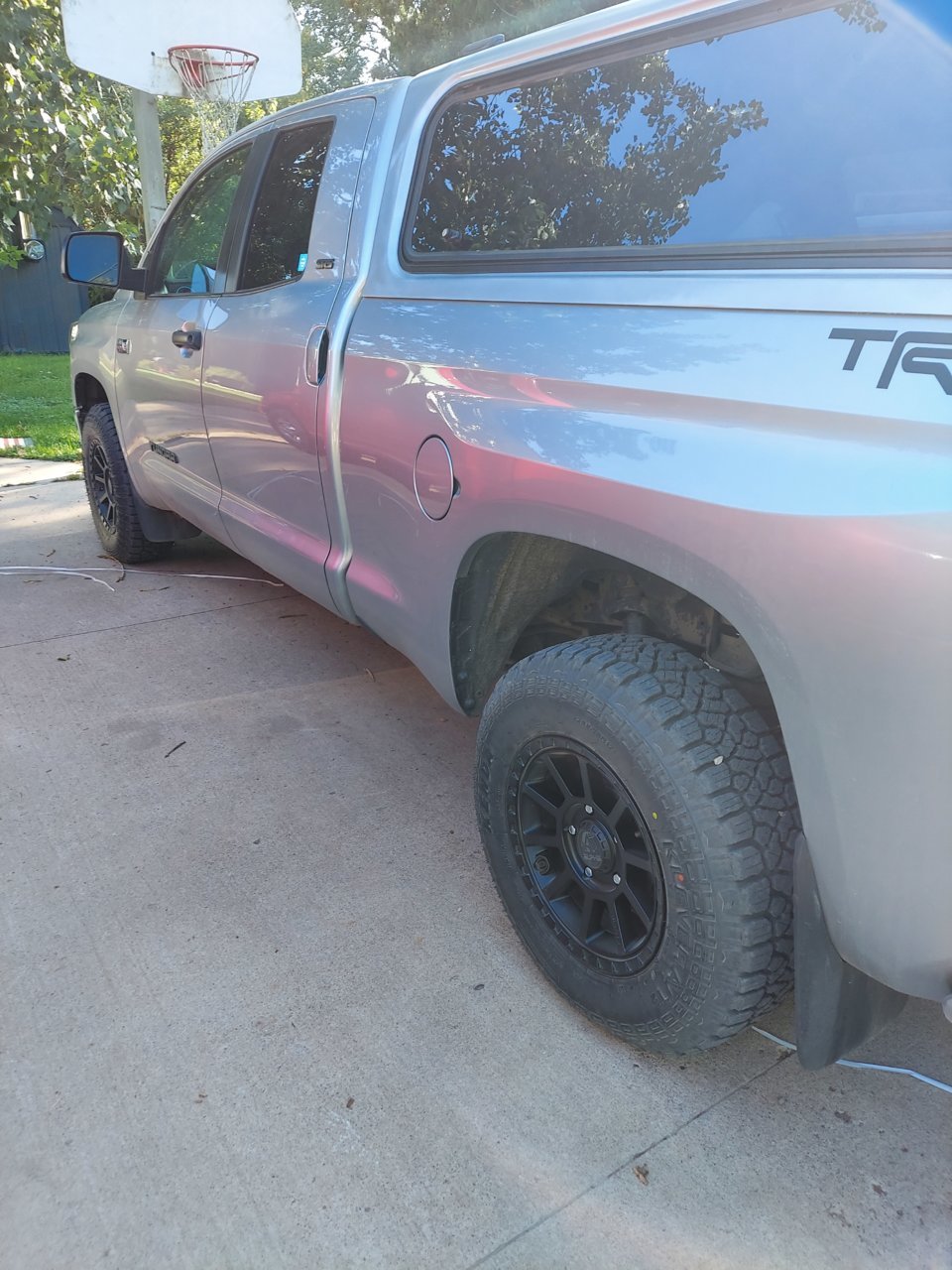

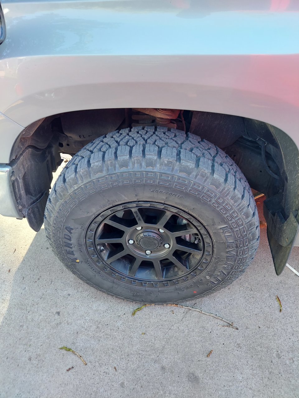

    New alpha rims with new tires :) looks good and they were able to use my factory tpms from the steel wheels.
