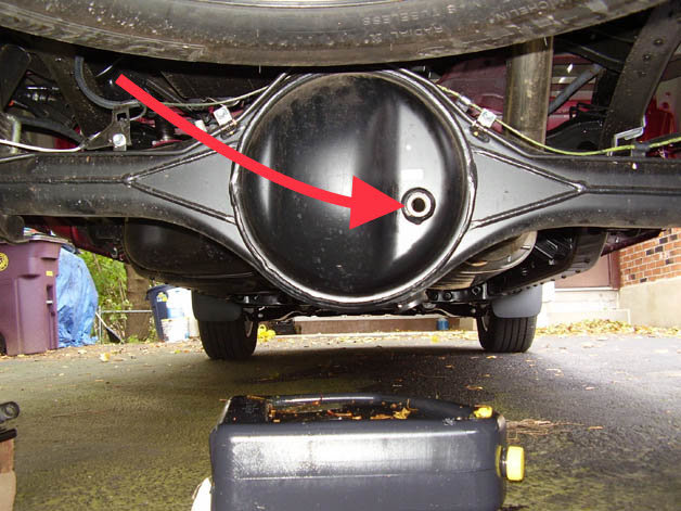

    Park the truck on a level surface, Pull the rear differential fill plug and see if there is fluid in it. Kind of sounds like the rear diff whining.

    Looking from the back of the truck to the front. Pull this plug and stick your finger in the hole, you should immediately feel oil right at that hole. If you don’t feel any or it’s lower than that hole get some 75-90w gear oil and squirt it in there until it starts to spill out. Let it finish running out wipe it off then put the fill plug back in. 67BAC46B-F274-4417-A83A-21FC8E129FDE.jpg
    If it’s dry in there the damage is already done and you’ll probably need a new rear diff.
