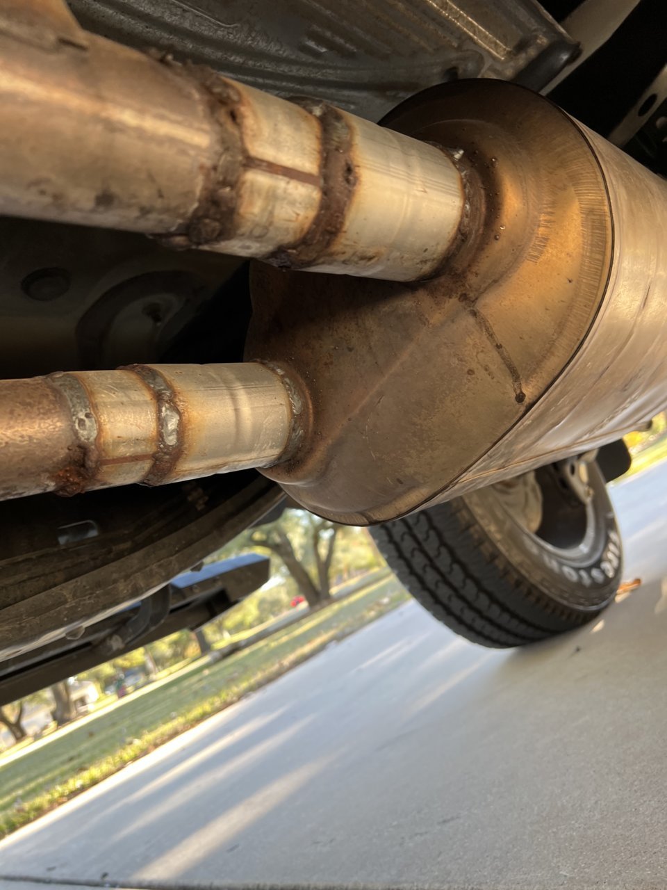

    Hello,

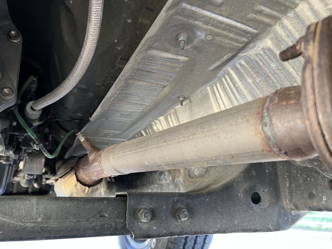

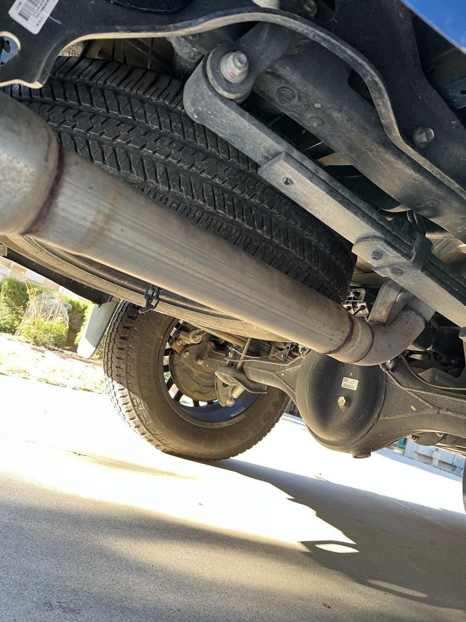

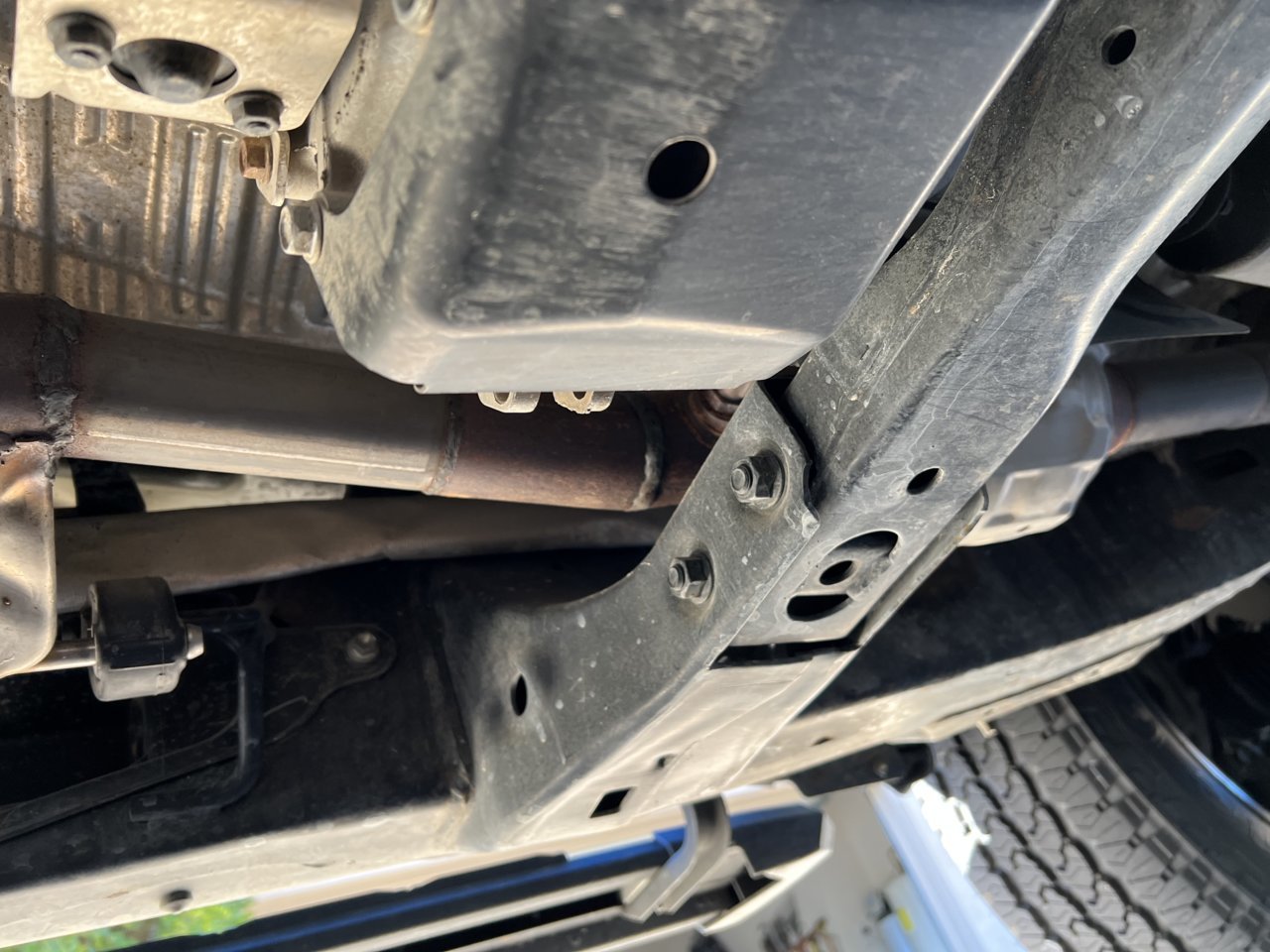

    Just picked this up about 4hrs ago. 2018 SR5 with 53k miles. It’s got a cold air intake on it and judging by the exhaust, that’s been modified also but not sure how extensively. The muffler says Toyota on it. Looks like it’s had the two rear cats deleted and I’m going to assume the resonator behind the muffler. Can y’all confirm that? The exhaust is super quiet inside and I’ll probably scrap it but wanted to check before I start going down rabbit holes. Thank you.

    @dirtydeeds is our exhaust guy. His systems are awesome. Yes, that exhaust has definitely been hacked on.

    It looks like that has the prestolen rear cats option.

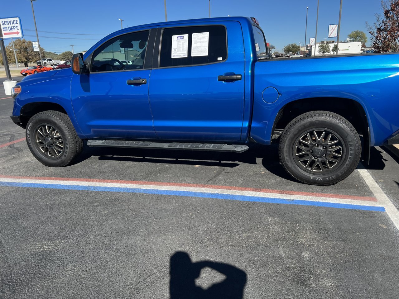

    Such a good looking blue you got there :thumbsup:
    Looks like it has aftermarket front and rear bumpers. Any pics showing those?

    Beautiful color. How much did that set you back if you don't mind me asking? I am looking for something very similar out here in Arizona. Nice catch on that!

    That looks a lot like a stock muffler.
    The tail pipe not so much.
    I think @Saltyhero13 is on to something.
    Either someone stole the rear cats or the owner just removed them.
    The front cats do all the work, the rears not so much.

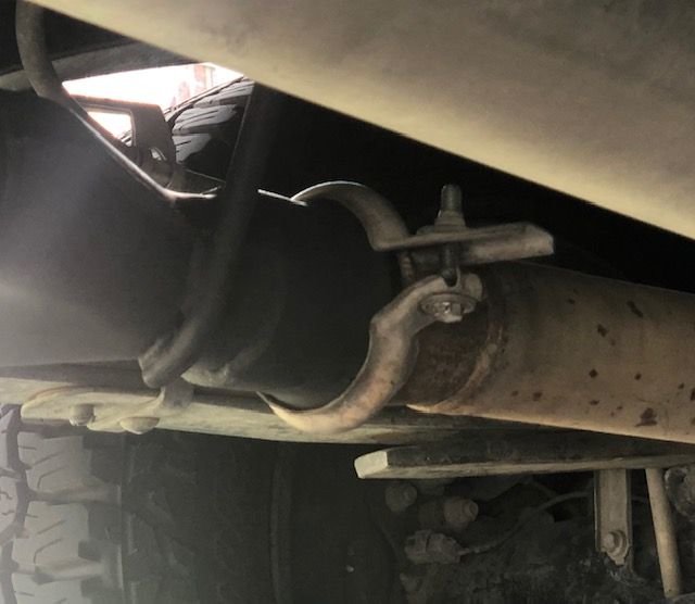

    Curious about the rear;
    Does it look like this (muffler to tailpipe clamp) and does the tailpipe stick straight out the back?

    Muffler is for sure stock. Clamp is the same. But it looks like it’s been chopped and welded on the part after the rear axle.

    ~$38k. Cheap considering the low miles. Normally they go for the low $40’s which is why I jumped on this one.
