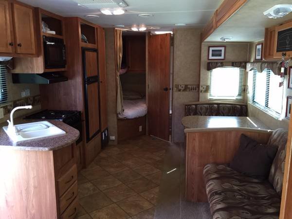

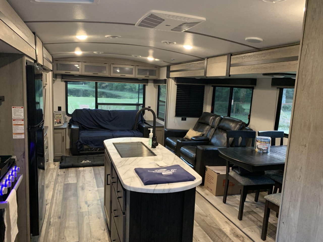

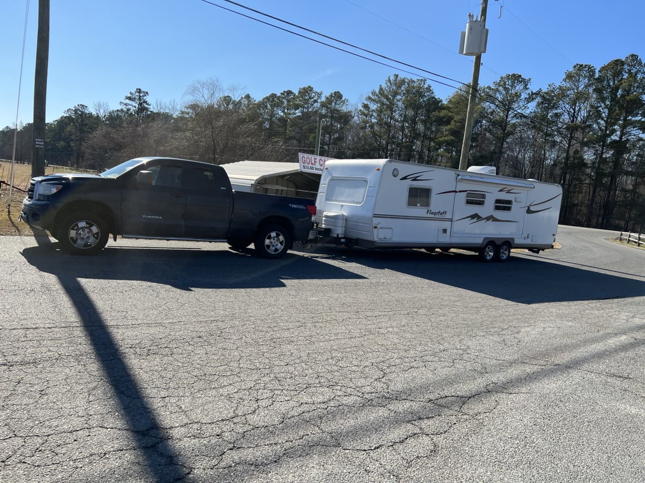

    This beast. Outback 292URL. 29’ box with 33.5’ overall length. Dry weight around 7100#. Probably sits closer to 8000# with our stuff and propane and a battery. Tongue weight around 1000# I would imagine. Haven’t scaled it. With the WDH setup close to ideal it squats the truck to level.
    58BEBAC9-37AA-4F4F-92B5-3C6007E03197.jpg E9F64889-668D-41DA-852D-7172D819A54D.jpg
    The Dude likes this.

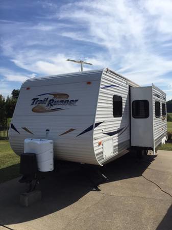

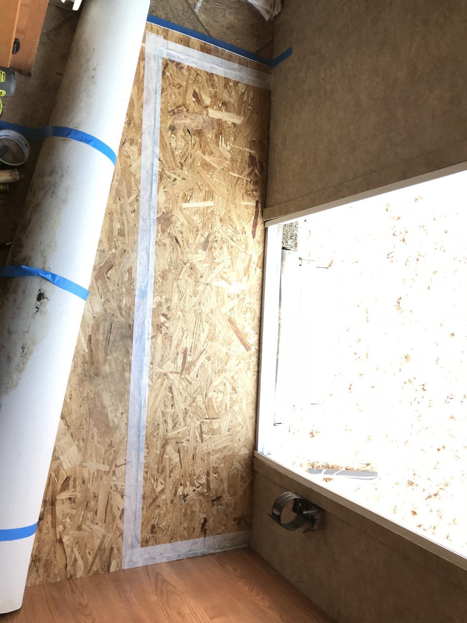

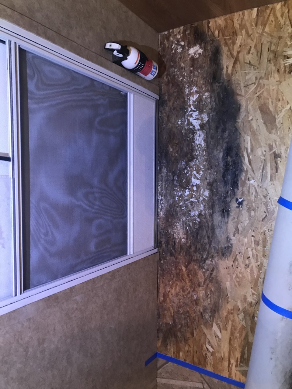

    This guy…..
    555EF177-40A1-42D2-921D-06F8DD418836.jpg 4AD6CCA7-940B-4F92-9CDE-40E18FAEF265.jpg EC4F9A61-68BF-4194-BF6C-27F564E12021.jpg

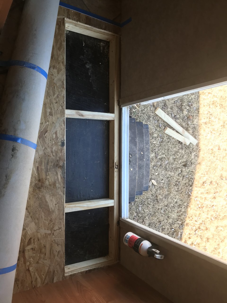

    nope :anonymous:
    21B794C3-636E-433E-B706-A86AC130B7B1.jpg 7EC99249-E81E-4FAF-B445-85FE26229BF7.jpg 23C1908E-6A9E-4E93-BAED-AC99563248CC.jpg

    You’re lucky you caught it early people said it goes all the way underneath the kitchen some of the slides.
    did you find out why it was leaking? Or where it came from?
    Is that why you guys got rid of it?

    Sold it when the kids got older and we weren’t camping in it. They aren’t well built, but to be fair, I paid a whopping $12.5k for it brand new. Sold it for $8500 after about 5 years.
    The rot is due to the most commonly overlooked part of RV maintenance, yearly inspection and waterproofing. Every window, every door and the entire roof. Gotta walk it and apply sealant where needed. This was the over the door sealant that failed. We weren’t using it much and I neglected it. There ain’t no marine plywood in these either. Straight up OSB flooring.

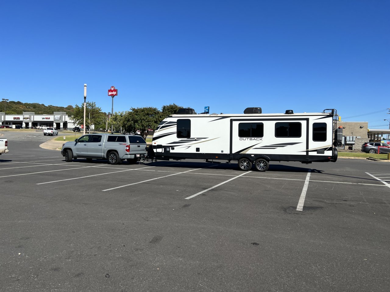

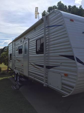

    This was my 32’ camper with single slide out. I towed it with my 2012 DC. Camper is around 6000lb dry. Not bad towing to local camping within 2 hours. Use highway preferably. You definitely feel it in high cross winds. I was definitely overloaded every time. But overall it was doable. A bunkhouse I don’t think I would feel as safe or confident in pulling with a tundra. Good luck.

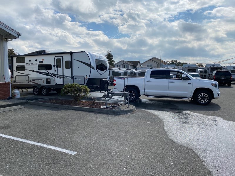

    This is ours, but it sounds like it's smaller than what you are looking for.
