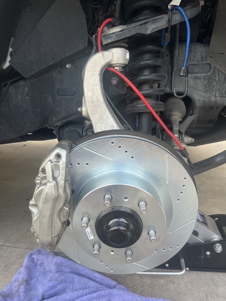

    Any time! I’m by no means an expert on suspension so hopefully someone else with a little more experience can provide some more clarity. That first paragraph makes sense to me. Here’s a pic of my upper control arm at full droop for reference. It’s a tough angle for that joint and I’m assuming that’ll wear out much quicker than the OEM alignment:

    since the caster is closer to being negative, the steering wheel is relatively sensitive. The truck drives straight but is influenced by how the road is shaped. More + caster = higher stability at higher speeds. If I’m taking a 270 degree on-ramp, it feels fine but coming out of the turn it feels like it wants to continue turning, if that makes sense. It still drives great off road, but I will be eventually upgrading to 5100s or kings and UCAs at the same time because the spacer lift rides a little rough as many can attest to. If I had the cash, I’d definitely do the buy-once-cry-once approach, but I’ll tell myself that I’m just upgrading things as I “need” them lol.
