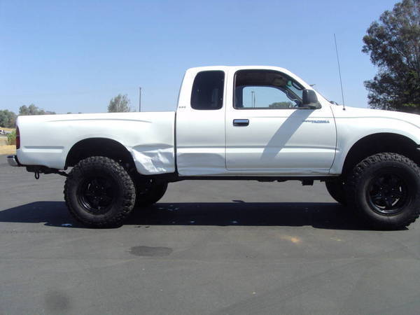

    I'm so new to Tundras that I don't have one yet haha, but I did a search on lifted 1st gen Tundras & my old Tacoma pops up !! Go figure...
